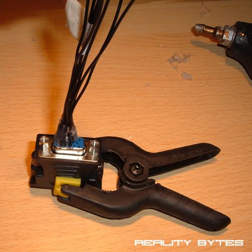

So today I wired up the video inputs to a VGA socket. The plan was to do this using a bare 15 pin D-Sub plug which would then plug into a VGA -> DVI adapter.
When I grabbed the adapter I noticed how easy it would be to plug the wires straight into it rather than solder them to the VGA plug. So I cut some lengths of solid core black wire and slotted them into the adapter:
Then labeled each one so I knew which wire was from which pin:
Used a hot glue gun to keep them in place:
And used heatshrink to cover up the wires:

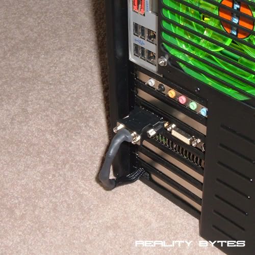

Lastly I connected up the wires to the loom already fitted to the screens inputs and ran it through the case, hidden behind the radiator, before coming through the rear expansion slots and into the graphics card outputs:
Now that this is done all I need is a new transistor and it will, at last, be ready to switch on.
