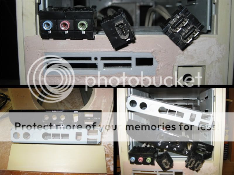

I salvaged the card reader and the usb, firewire, and audio ports from an old Compaq that was laying around.
I am planning to have it all seamlessly integrated into the font panel.
The ports can fit inside the metal holder, and then line up with the plastic front part. But those don't fit inside a normal 5.25 bay. So I'll need to cut them down.
So I need to decide if I want the ports left aligned or centered.
I have made a helpful image to show each.
I think the right picture looks better.
I like the left better, and if you can do something good on the right with the extra space, that's even better.
