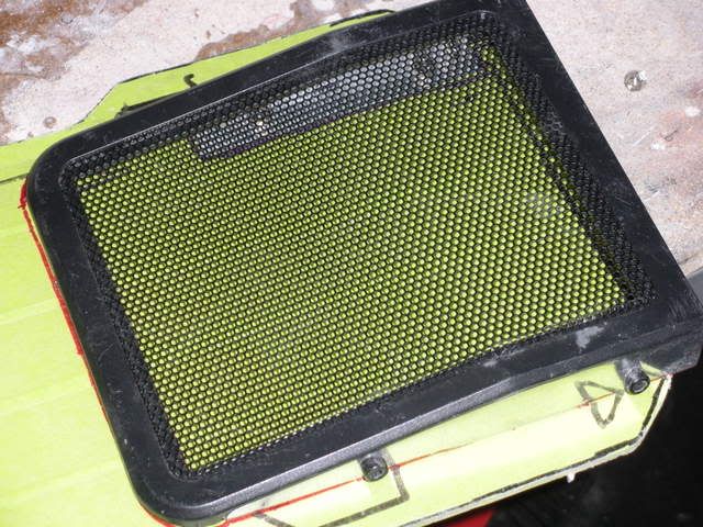

next thing i worked on today was cutting out the honeycomb on the rear 120mm fan
i didnt get a pic of the finished cuts ...but its all cleaned up

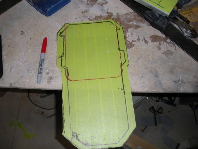

i laid down my basic outline for the back panel
then got to cutting
i knew it would be a lil trouble getting dimensions correct (so it looked right when mounted) so i cut it a lil oversized

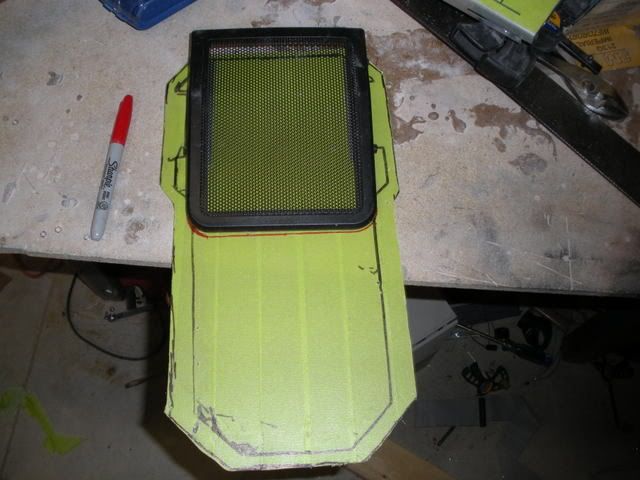

i then followed up with mounting it to the back of the case and tracing out the fanhole and the edges of the IO ports etc
and all cut out..
i followed this with mounting it back to the case and taking my sanding drum on a dremel to the fan hole and a file to the edges along the ports..

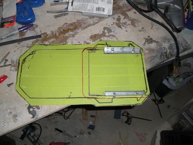

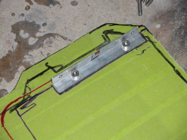

first thing i started with removing the rivets in the top panel of the case
i then lined up the duct where it will sit in its final placement
and traced it out
next i mounted the duct supports
with the duct fully mounted...
tomorrow i shall cut out the hole in the acrylic for the duct and mount the window

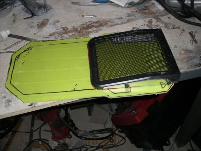

today i started working on my cut out for the power supply
and all cut out
i then tapped the holes where the rivets used to be, i also did this for the front end of the top
all tightened down..
here it is with the back cover mounted, and my test PSU installed... i also put in my broken fan housing just so you have a basic idea of how it will look when completed

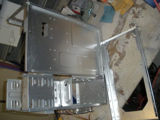

started cutting my side window of my case...
then ovride offered me his saw...its got frikken lazer beams
tonight i started working on my top trim...again...needed some redesign to fit with the duct
and all cut down to size..ish...need a bit off the length of it
and filing down that cut edge
after some drilling, cutting, and bending this is where im at...but im not done yet!
