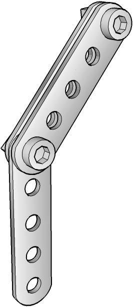

Well since I'm waiting on C.S. to contact me I've been brainstorming and thought of a possible solution to my problem with supporting the weight of the monitor with the backbone. A friend at worked suggested using some small metal plates from a model kit.
Girders & Gears
I'm not sure of the exact measurements but it just might work. I'm also not sure of the strength of the plates they might be to thin to be any good. I made up some more SketchUp models to show you how I play on using them.
I just place the plates in the middle of each vertebrae and then drill a small hole on the side of it so I can gain access to the alan screw so I can loosen/tighten it at needed.
wow, thats a great idea...I think they should be strong enough, especially if you use sets of 2 and 3, rather than 1 and 2. +rep btw
