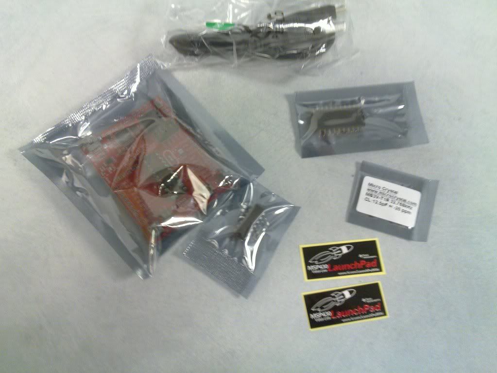

Inside:
And the included parts:
launchpad dev board
usb cable
both pin and socket headers (you solder on whichever you want)
MS3V-T1R 32.768kHz crystal
MSP430G2211 (in separate packet)
MSP430G2231 (on the board)
2 stickers :D
