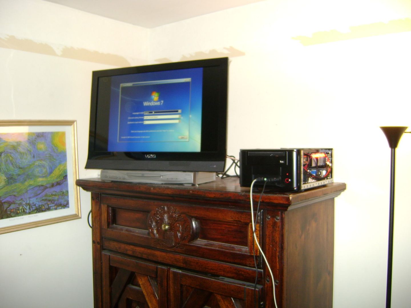

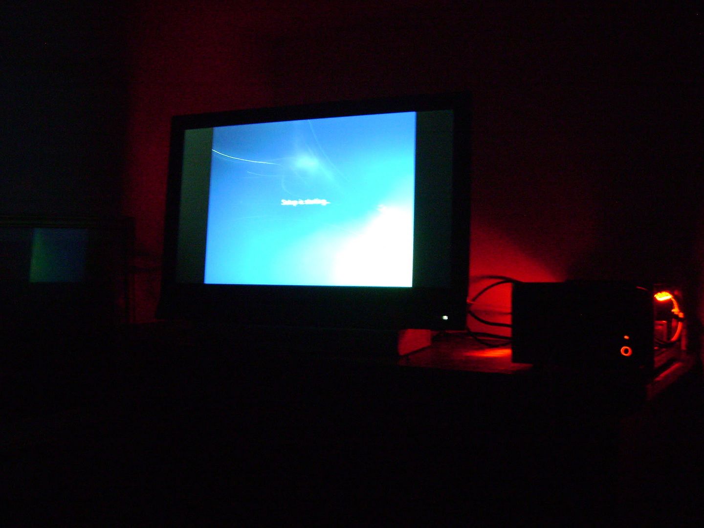

everything went smoothly except for the damn ground tabs on the i/o panel. first the one for the ethernet was hanging down, then the one for the hdmi port. so after installing and reinstalling a few times, it was time to hook to the tv and start installing windows.
and here's a picture in the dark.
the cover isn't on yet because i remembered i had another power supply that i could use that would make more room in the case. that mini update will come in a few minutes after i take a pic.

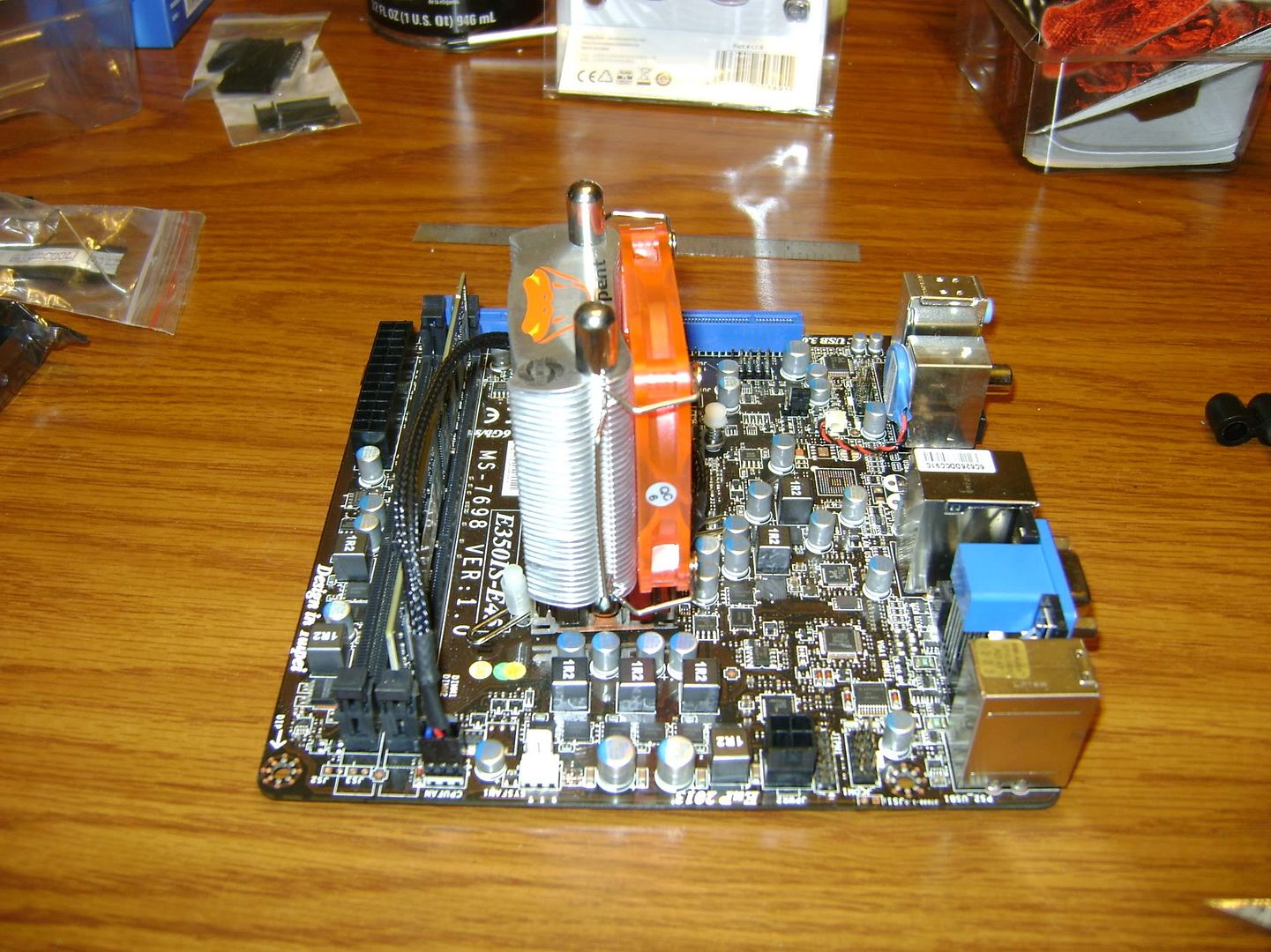

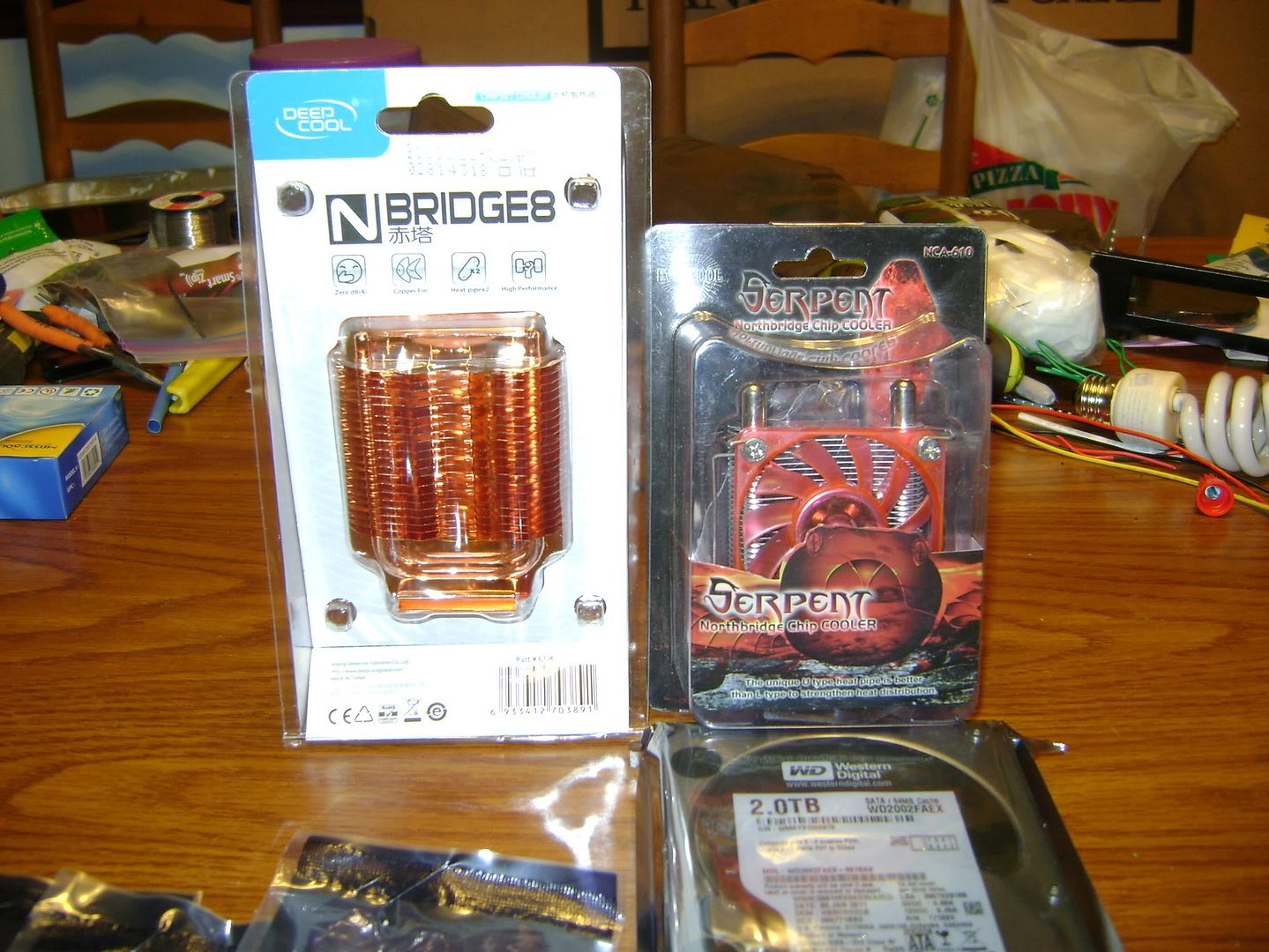

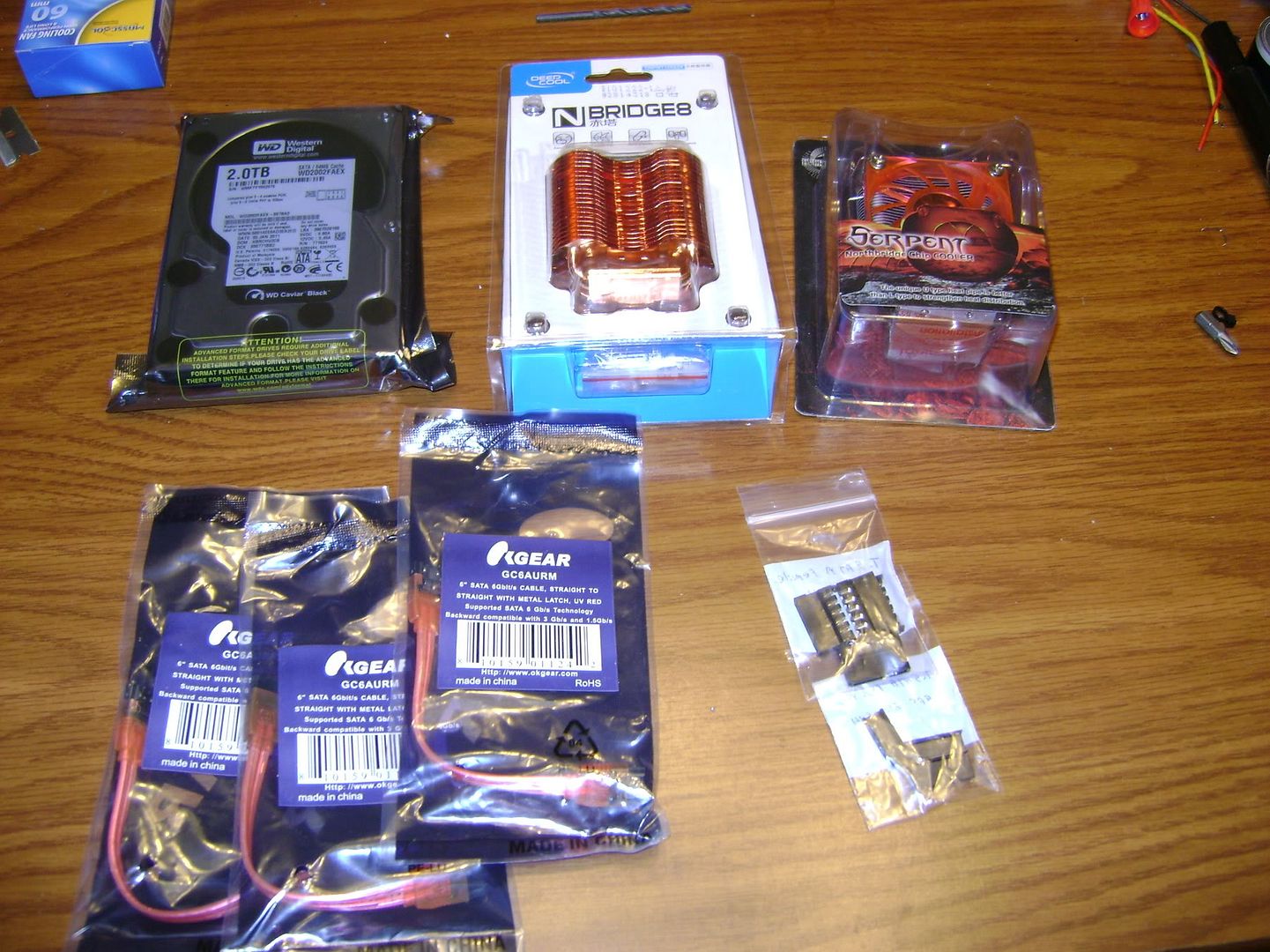

i received a new 2 TB drive, some 6" red sata cables, a couple of ginormous northbridge coolers to use as a cpu cooler, and the sata power connectors.

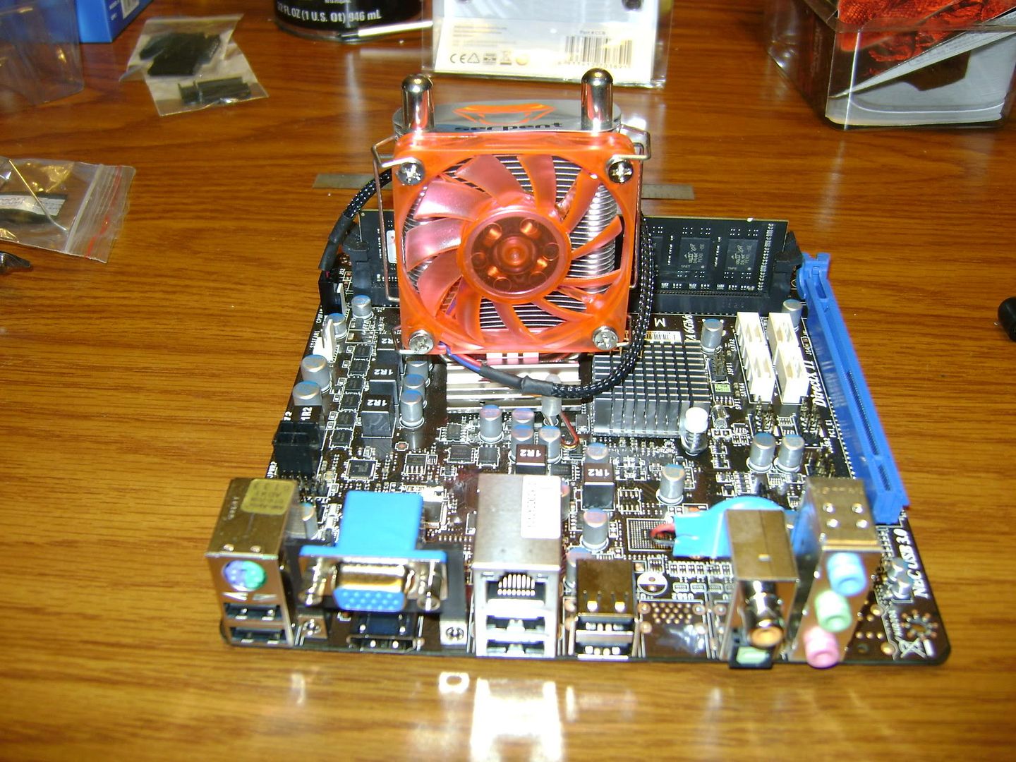

first thing was to mount one of the northbridge coolers. the big all copper heatsink didn't fit due to the heat pipes sticking too far out, but the serpent cooler with fan fit great. only problem was i couldn't get the mobo back in the case with it mounted, so i had to take it off, install the mobo and then put it back on.

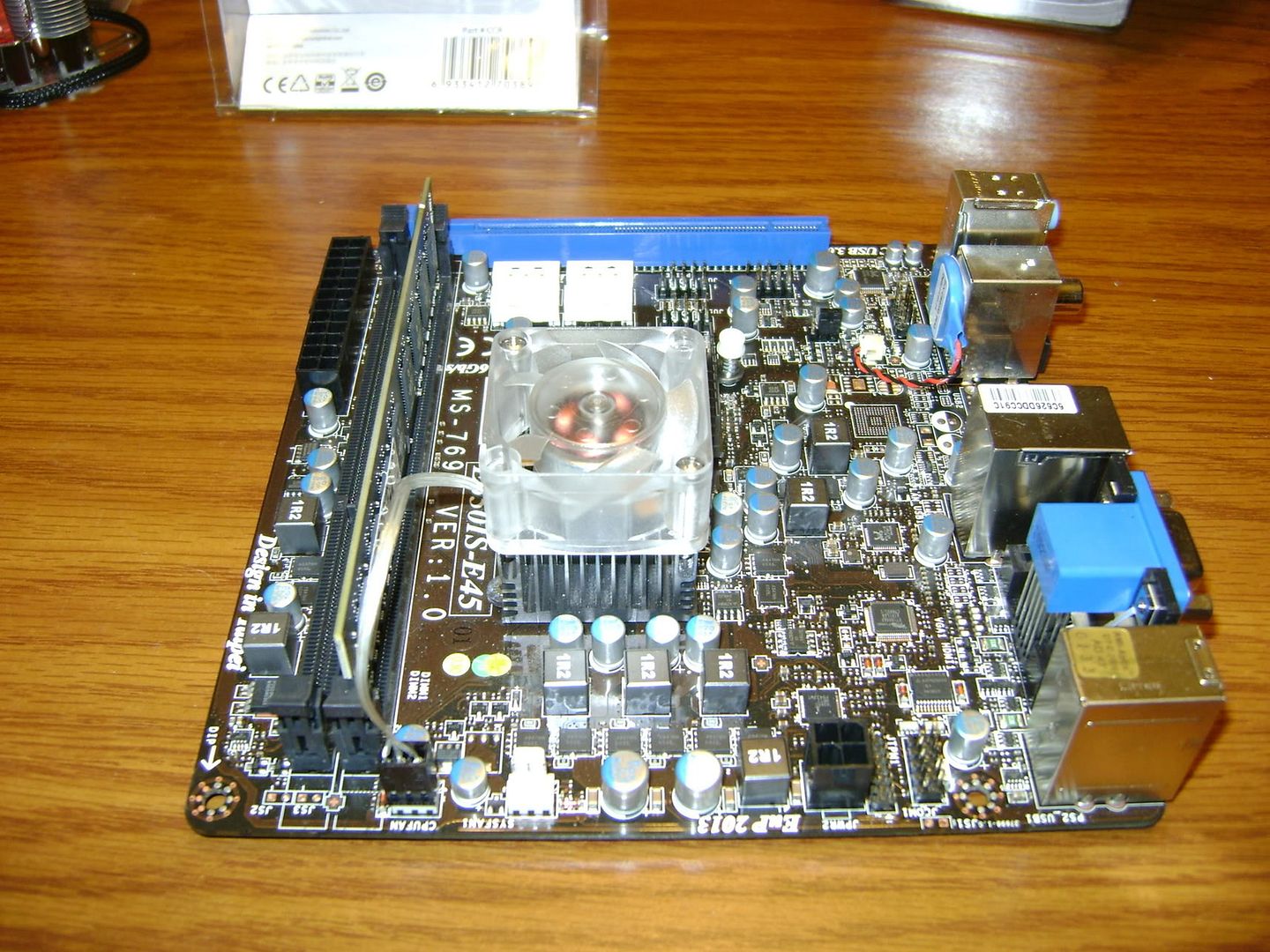

here is the original cooler with the 40mm fan.
and here is the the new cooler mounted.
this is going to provide much better cooling!
i started installing the sata power connectors and realized 2 problems. 1: i used too thick of wires to put the cap on and 2: the position of the connector for the 2 TB drive was too far over to one side, so the wires weren't long enough to reach. so i'll have to replace the wires with smaller gauge and make them longer so i can hook up the big drive. at least the computer is functional again though.
oh yeah. the cpu temp went from 56c at idle to 49c at idle with the new cooler. and it is soo much quieter now. i can actually hear the hard drive over the fan now. that makes it so much nicer watching movies late at night with the volume turned low.
