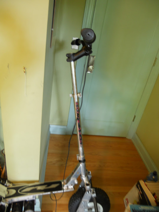

The controller arrived, along with a twist grip throttle, a fuse, and a few other small parts.
Next to a DVD for size reference:
I replaced the handlebars with the bars and stem from a scrapped mountain bike.
What I've mainly been working on is building a new platform. At first I thought about just buying a sheet of 1/8" aluminum, but I decided to see what I could come up with with materials I had on hand. I realized that I had a large amount of carbon fiber tow left over from the bicycle I built. I built a frame to stretch the tow over, and layer by layer formed it into sheets by soaking it in resin and clamping it between two pieces of plywood. The final sheet has 5 or six layers in each direction. I'm sure the carbon/resin ratio is not the best, but it still is unbelievably strong.
Here's the sheet:
Cut to shape:
Since CF isn't very abrasion resistant, I cut a top layer for the platform out of a scrap sheet of polycarbonate I had lying around, to stop the CF from wearing down. I cut the polycarbonate platform a little bit wider than the carbon layer, so that the polycarbonate will take any impacts, rather than the carbon. Right now, I'm working in bonding the two layers together. The resin I used on the carbon does not bond well to the polycarbonate. I've found that CA glue bonds the two very well, but I haven't thought of a good way of applying CA over such a large surface area.
Polycarbonate:
That's all for now. I've ordered a few more parts, like a battery charger and a master power switch, and I'm waiting for the batteries to come back in stock.
