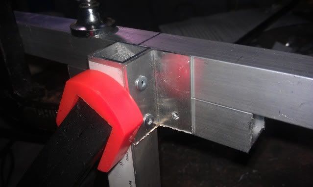

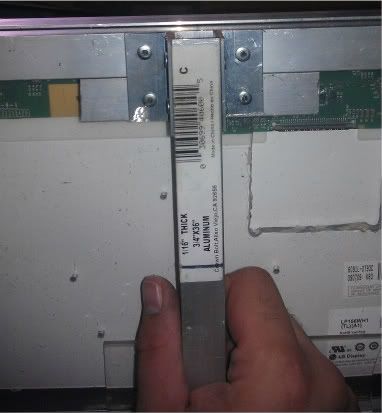

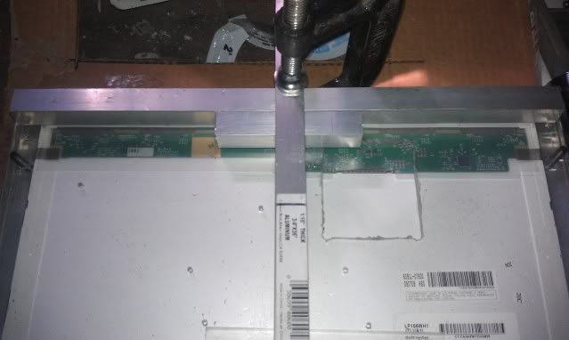

The vertical bar (which will be connected to another part later) needs to be affixed vertically to the mount-bar.
This was done with some angle-stock and the old modder's fried, pop-rivets:
One riveted, the mount is mostly secure:

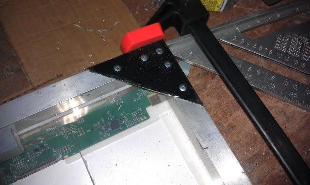

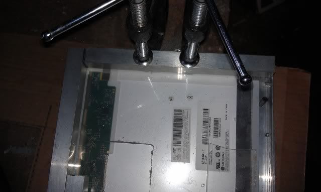

Problem is, I really just didn't like the amount of flex in it. I would probably be fine, but I don't want to risk the plexi back-plate cracking or the panel itself twisting. Therefore, I reverted to two rules I learned back in my days of stage construction:
- If it's on the back, no one will see it or care and
- When in doubt, over-build.

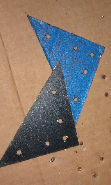

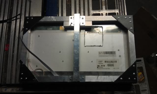

So, to solve the problem, I cut another piece of the bar stock to support to go along the side, along with corner-brackets:
Thing is, this one support stabilized the whole thing, and I'm all out of bar stock. I could just use a piece of angle stock to make the monitor look the same on both sides and have the main construction done...or I could go to the store tomorrow and do it right. In this case, doing it right won out.

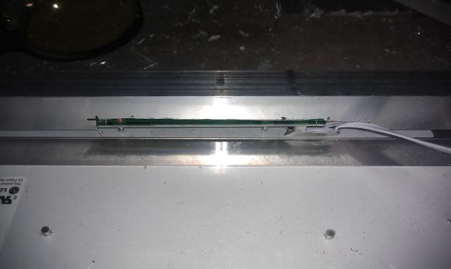

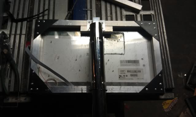

I installed the bottom frame piece and had to cut a notch for the circuit-board. This actually serves double-duty of housing it (no metal touching metal) and bracing the back.
Also, this piece meant that I could anchor the bottom of the upright:

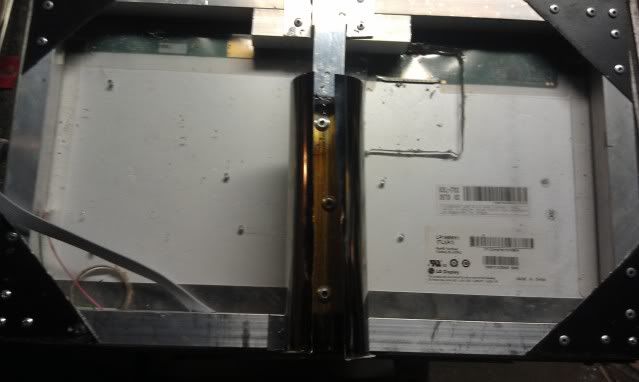

Now, here's the part that I wasn't able to explain before. Since I can't get rivets from the tube side or the pipe side, I had to get creative. For this, I used two pieces of pipe, and split one to make a sleeve:
...and then, just slid the other one inside and riveted it.

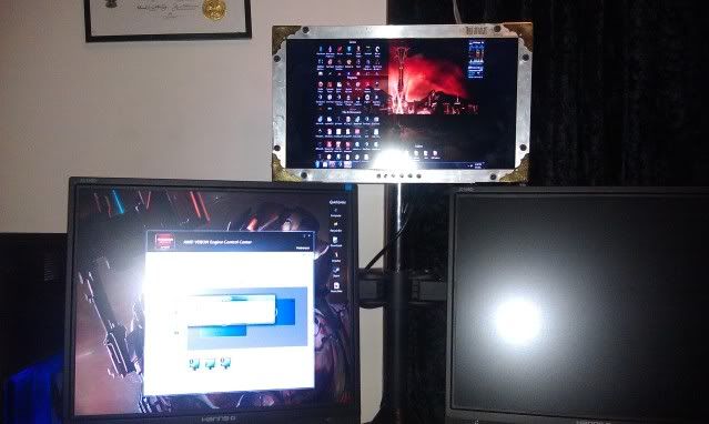

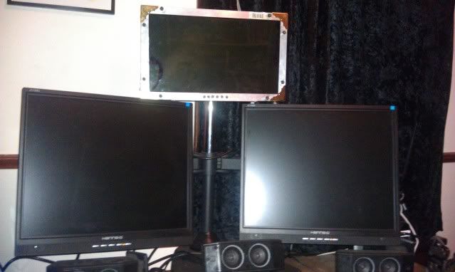

Now, once this was all assembled, the whole thing just slides over the center post of my monitor stand. In place, I realized that it's a little crooked, but this is easy for me to re-rivet and fix. The next step will be to put the final panel in place and test it to make sure the viewing angle is right. If no adjustments need to be made, I will make the buttons and paint the whole sheebang.
(Note, you can see That Which We Won't Speak Of on the left.)
