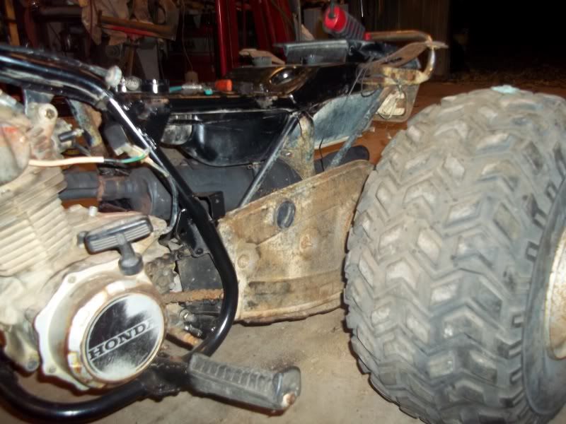

Got the chain on, and fixed some connectors.
Tire off for more room.
After getting the chain wedged back on the rear sprocket, I loosened the rear axle bolts, and the adjuster. How it works is two top bolts that act as a hinge, and two bottom bolts that go through slotted holes. So the entire axle can pivot on the top bolts. Then it uses a threaded rod to adjust the tension like anything else.
Then I used a dead blow to knock the rust off, and move the axle forward. That allowed me to get the front sprocket with the chain on. Then, just installed the locking plate.
Then I went to the back and used the adjuster to get proper tension on the chain. After this, I locked it down.
Next, it was a matter of straightening the bent dust cover, and bolting it on.
Tire back on, and It it good to go!
