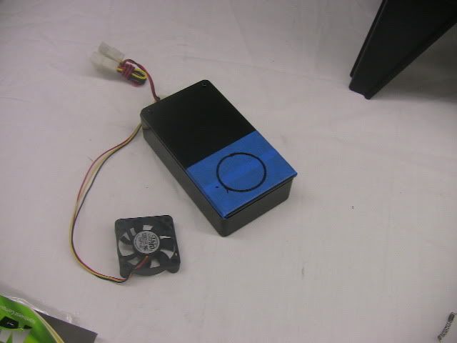

I stopped off at the local electronics store and picked up a few things.
Like a mad scientist I rolled my hands together in anticipation of this creation. It will be the best smoke making gadget ever devised!
I got my parts sorted. Busted out the Dremel, marked the holes, and let'er rip!
I made a little chimney to focus the smoke upward. The fan will blow air into the box forcing the smoke out.
I wired in 2 connectors to hang on to some wire I found inside my wifes hair dryer. (Don't tell her I took it}
I wrapped it around some fire proof rope, dropped some smoke oil on it, and poof!
I tested it with a spare power supply and used the wires for a fan hookup for my power source. The wire gets orange quick and makes it smoke A LOT. I might have to tone it down a little.
All put together and looking nice..
I installed it at the top so it could point out the chimney by making a bracket.
I tried the top and it fits perfect. I can't believe how smoothly this mod is going. 8)
I plugged it in to the red/black wires for less amperage to cut down on smoke but it just didn't make enough to shoot out like I wanted. So I decided to plug it back in to the yellow/black to get more juice.

I realized that when I did my full burn that I had not turned the little fan on, which most likely let everything get a little too hot. Also, a "full burn" maybe isn't the best idea unless I want a "Complete Full Burn" as in total meltdown of the entire mod.

FWIW fire proof rope is like any other fabric else thats "fire proof" where it's actually "fire retardant" for a certain time or temperature. That rope they use in stoves is mainly as a heat gasket, where rubber cannot be used, but it won't see a direct flame for more than a few seconds at most. If you hold a lighter to it (or a glowing orange coil) it will most certainly ignite sooner or later :D
Methinks you need a metal project box instead, and don't forget to turn the fan on!
