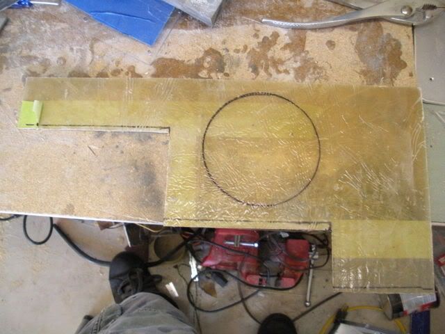

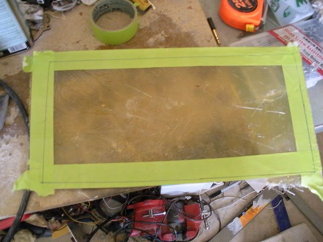

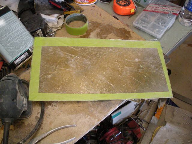

i made a flat sheet of fiber to cover the back..itll help in the future when i have a couple of other mods i need to do
i then cut it down to near size....ill sand/file it down the rest of the way when i get the rest of the cuts drawn and done

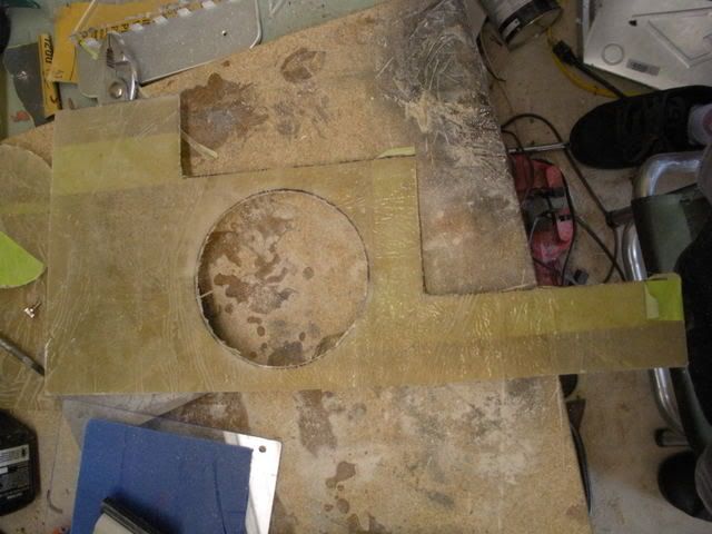

next thing i worked on today was cutting out the honeycomb on the rear 120mm fan
i didnt get a pic of the finished cuts ...but its all cleaned up

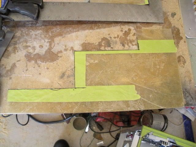

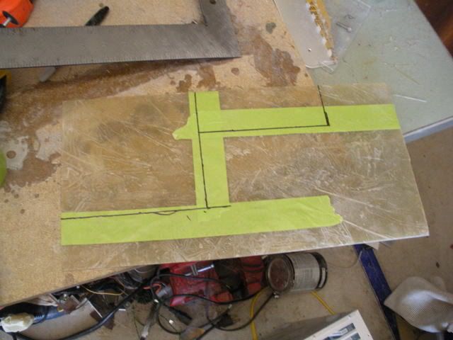

i laid down my basic outline for the back panel
then got to cutting
i knew it would be a lil trouble getting dimensions correct (so it looked right when mounted) so i cut it a lil oversized

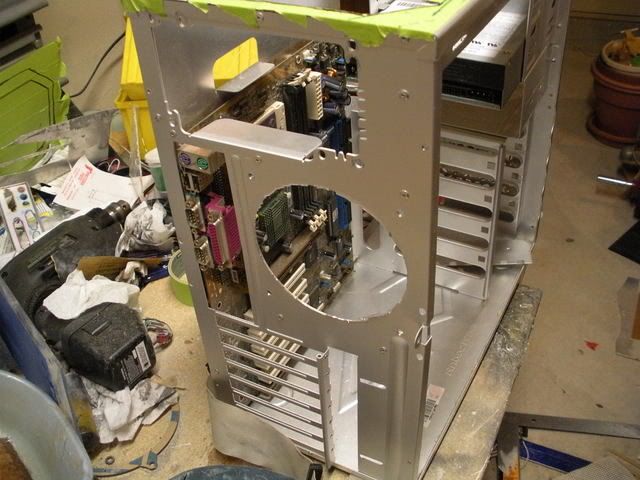

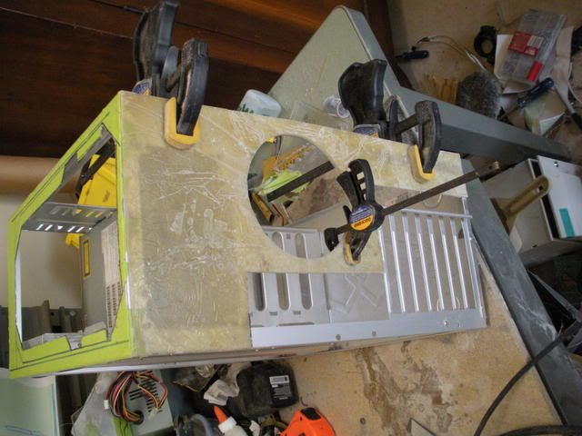

i then followed up with mounting it to the back of the case and tracing out the fanhole and the edges of the IO ports etc
and all cut out..
i followed this with mounting it back to the case and taking my sanding drum on a dremel to the fan hole and a file to the edges along the ports..

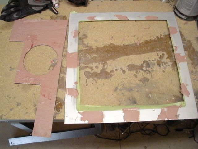

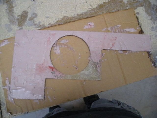

after i got it all cut.. i laid some bondo, to even up the surface, there were some valleys in the resin of the fiberglass
and whil i had the bondo out, i went ahead and filled the mount holes for the original window
this is where im sitting with this mod as of now,

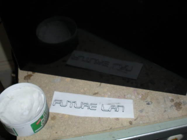

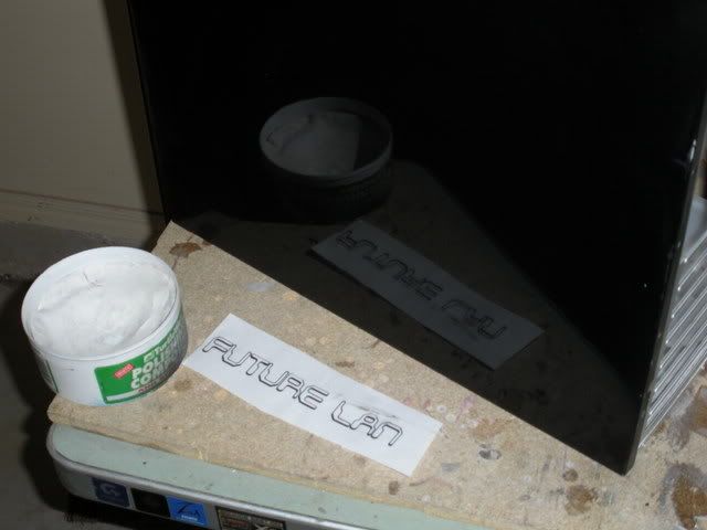

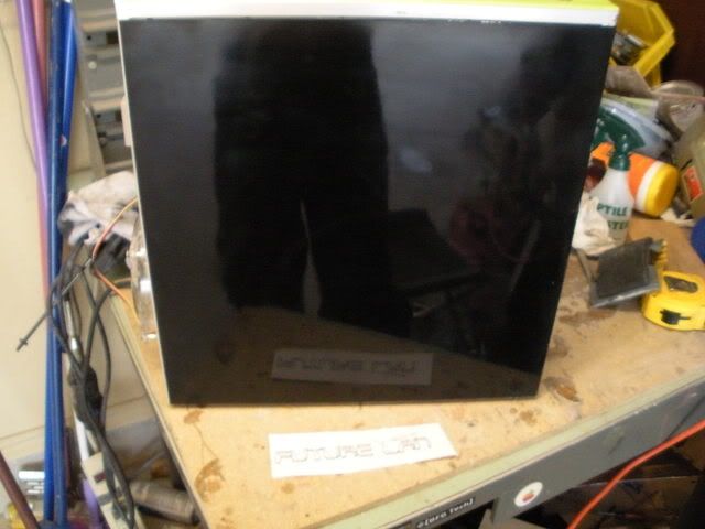

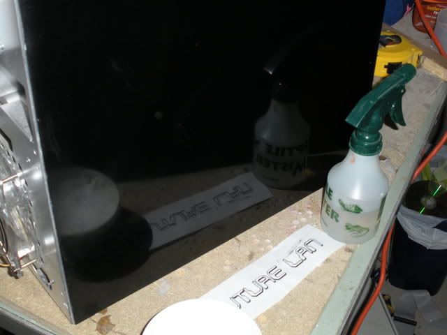

ok...this is just a bit of a small update... i painted my right panel and started polishing the paint...its about 99% of the way there...just gotta touchup a few spots and itll be done...not gonna say too much...so on with the pics!
this is where i am now....ive also done a little bit more on my back cover...ill post more pics of it when its done being sanded and i start painting
your thoughts?
WOW! Love that finish! What did you use to polish the paint?
