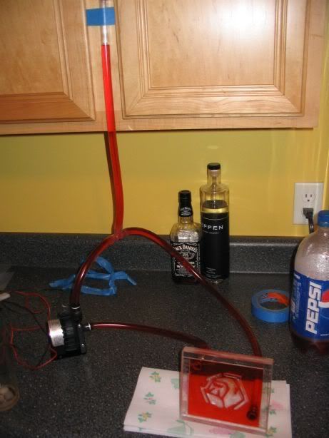

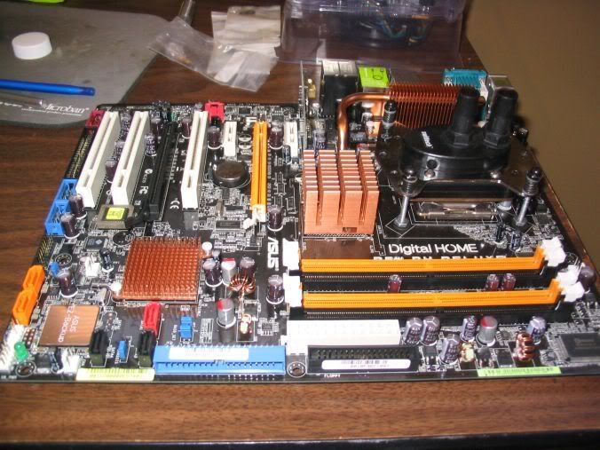

Neither did I when I started, this is my first watercooling experience. I'm letting my system run right now as we speak, I was so impressed with how quiet it is once I let it run and get some of the air out!! I had heard that thsi pump was quiet when it was on setting 1-3, but got noisy when it was cranked up to setting 4-5. So I decided to crank it up and see, well when I went to the dial I found out it was already on setting 5, hah! I still have tiny micro-bubbles, but from what I'm reading those will work themselves out.

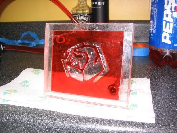

I also have a very very tiny leak in my water-cooling window. This one is very very small, I let it run overnight and only had maybe a few drops worth of leakage. I'll apply more weld-on once I take the test rig apart and it should be allright. However it did concern me when I started to think about how I'm going to attach this to my PC. My first thought was to screw it into some square brackets mounted in the 5.5" bays. But now I'm thinking I'll still use square brackets, but attach with some heavy-duty double-sided tape.

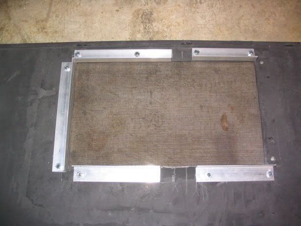

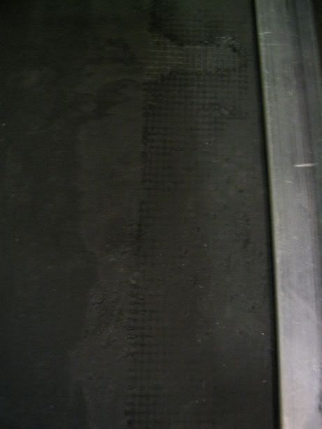

I put a small framing up on the right side panel around the hole i made for the duct. I also used bondo to lay some mesh down across that hole. The framing will hold down an air filter I'll install later.

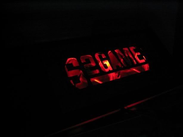

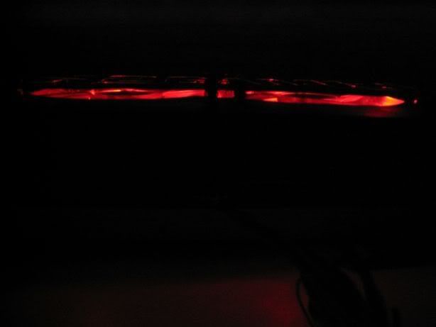

Here's pics from the top fan grill, didn't come out QUITE like I wanted. The full logo isn't lit because the grill is wider than the fans =/. If anyone has any ideas how to light up that whole grill, I'm open. The only thing I can think of is to use some frosted plexi and mount the grill and inch or so off the top of the case. However, this would restrict air flow and be a bit louder =/.
I also threw in some pics when I was testing my custom window for leaks.
Your custom window is excellent. The letter look nice lit up to.
Wow looks awesome. Love the idea you have going with the water cooled window

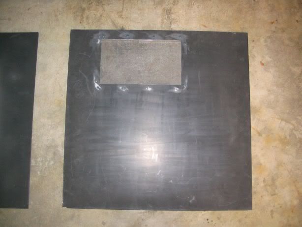

I cut the hole in the side-panel for my custom ducting. It came out pretty good, I didn't have to bother making extra cuts to make it fit right. I decided to go with something relatively plain.
You'll see what the bolts are for in a minute.
Here's the backside of it. I attached those square brackets to make sure I get a decent seal to the side panel. The gaps are there to make room for the vertical support bar in the case. The mesh I held down by hand and used bondo to attach it to the side panel, man that is AMAZING stuff. I also used it to patch some holes that I ended up not using in the top panel.
Also, the advantage of the little L-brackets is that I plan on pinching some sort of air-filter in there as well so I don't clog the radiator/dirty up my duct. I'm thinking women's pantyhose work the best, so I'll probably go with that.

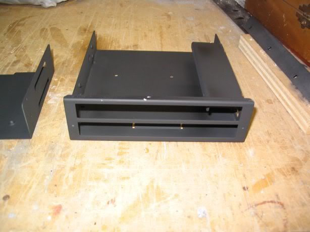

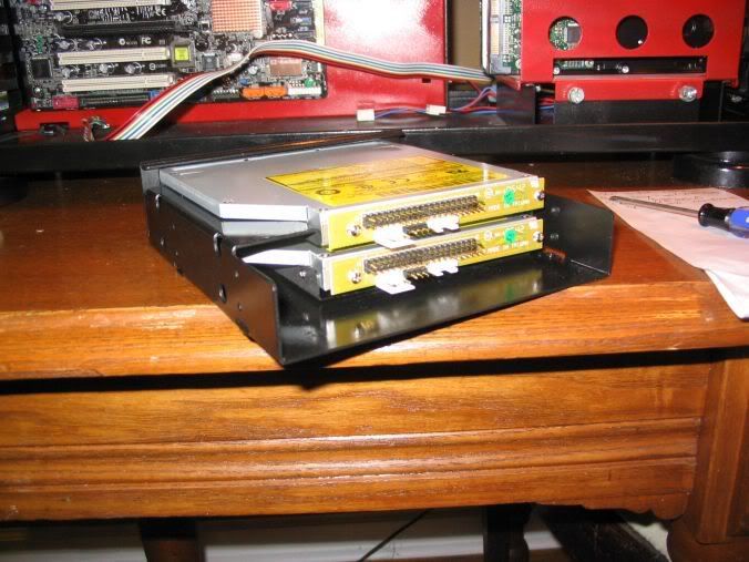

I decide a long time ago to use slot-loaded slim-drives. Just because I knew my water-cooling window would take up a lot of room, and because I liked the look of slot-load. So I had to order a bezel that would fit two slim-drives in one 5.25" bay. I just primed it and I'll paint it on Saturday when I go to do most of my painting work.
I'm still a little unsure how to mount my water-cooling window. I drilled these holes in the side to attach L-brackets to. I then planned on using tiny screws into the window. However, I don't think I want to do that anymore for fear of risking some more leaking. I think I will just end up installing the square brackets and using some heavy-duty double-sided tape.

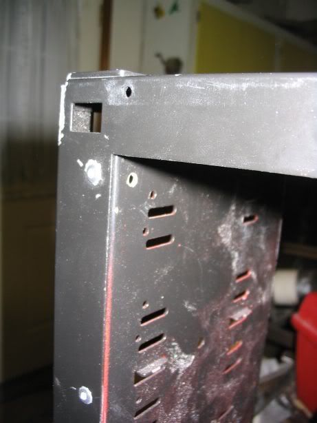

And here are just some random pictures of the case. I know it looks dirty, there's a lot of dust and particles in there from various projects going on in the garage, not just mine. I'll be blowing it all out and cleaning it before it comes time to bring it home to my apt. and start my wiring/hardware install.
I've got this big open area under my PSU now that I moved it. I have no idea what to use it for, probably to hide cables in I think. Anyone have some ideas?

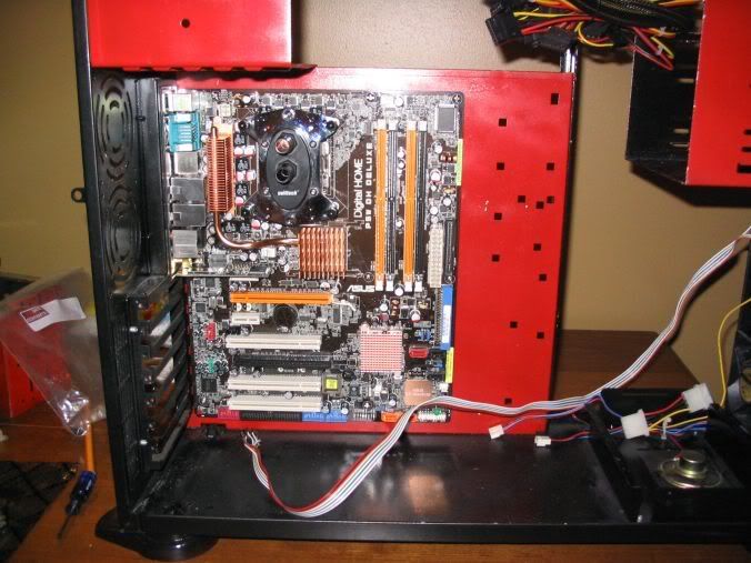

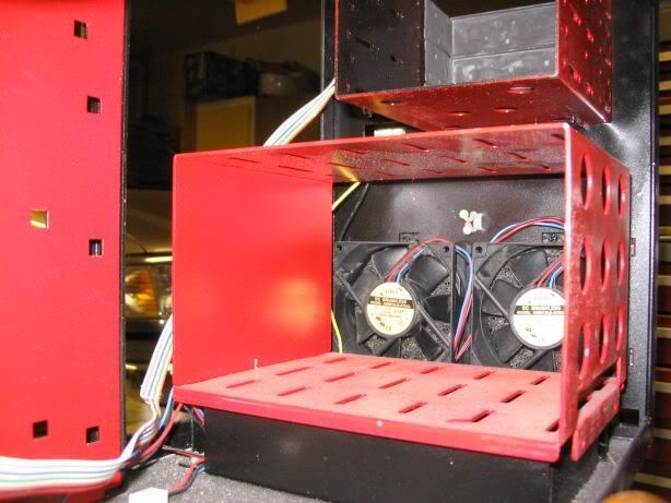

Started assembly. Forgot to bring home my dremel from my workshop (aka relative's garage), so assembly was halted for the day. Here's what I got so far.
I also started painting the side-panels. The first sanding-paint job looked really really good, only 3 more to go. I'll remember to bring my camera for pictures next time. I won't bother with descriptions/commentary.
The plan is to assemble it without the side-panels. Let it run/leak test/install windows/programs, etc. etc. while the side panels are being finished this week. Then it's done.
