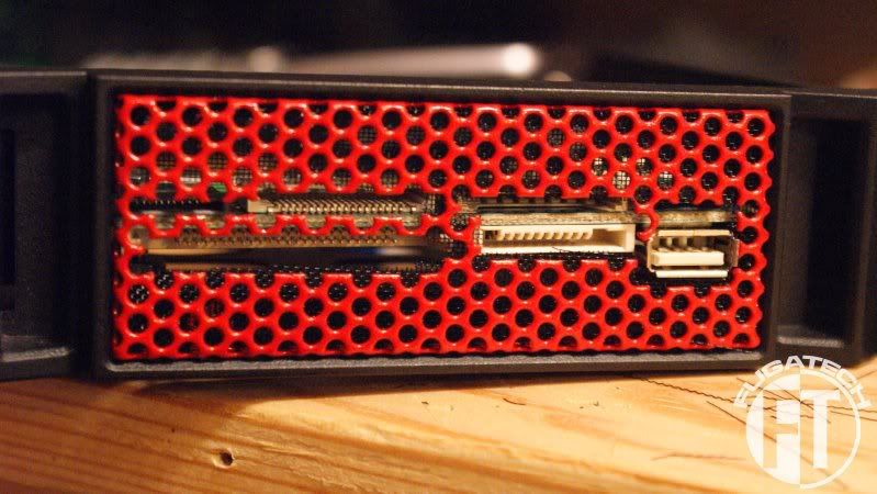

I had the 2.5" media card reader just sitting in one of the SATA hot swap front bay drawers and I had enough of that. Its not a mod unless your cutting it up. So here goes.
Since the HAF-X is lame and doesn't have a 2.5" bay in the front.. I have to make my own. Here I cut the bay drawer so it could accommodate the board inside the media card reader.
Here is the board.
Whew, fit on the first try.
Next I cut away the plastic lattice work on the bay cover.
Then I had to make it about 3/16" wider on each side but I forgot a pic of that... oh well you get what I mean.
Time to start cutting up the bay cover mesh. Here I taped one of the extra media card reader covers to the mesh so I had a template.
An hour later I had this.
Since the bay drawer doesn't have the nifty tabs for the board to screw into I had to get bigger screws and nuts to make it work.
Here is what it looks like on the inside. You can see I have 1 nut on the top of the metal.
And one underneath to make it tight.
Looks good right?
