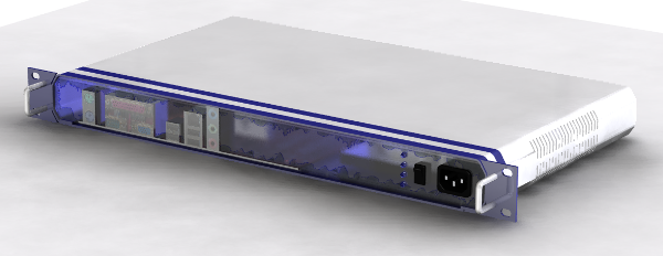

Right, I did some thinking during studying and I might go for a white case with blue accents. The render below show how I had it in mind. I thought about pearlecent white and metallic blue paints. I do think there should be some kind of graphic on the top of the case and maybe even one on the frontpanel. Tell me what you think...
silverdemon
tinker
...They build sooo much extra space into the rack-mount switches...
Well, actually, the motherboard does not even fit in this housing... The main issue is the height; the audio ports on the 'backpanel' (now in the front) are a bit too tall. I can show a render when I'm back at my room...
Here's a render of the front panel straight from the front. The green line is where the edge of the housing starts. You can see that the audio-ports on the backpanel are about 0.5mm too high to fit in the housing. So I have that much space! Actually I meassured it, I have exactly 41 mm of space between the top and bottom of the casing...

Have you installed RAM on that mobo just to see how tall it is, it may not fit in that rack. I know my RAM sits higher than my rear connection modules.
Do you need the audio ports on a server? Even if you do, you could remove them and solder wires to the board connected to panel mounted sockets somewhere else.
I measured my tallest RAM module, it's 35mm from the board to the top. That should give me just enough room...
Na, I probably don't'need it but I think I can figure out a way to fit everything inside the housing with no soldering. I think that would be the best option because: 1. my soldering station is broken and 2. I'd rather not solder this board, as it is actually my roommate's board...
What do you think about the color-scheme? any suggestions?

Right, I did some rendering again. I like the idea of (fire and) ice so I tried to get a frosted look on the front panel. I think it will look nice, though the render is not 100% as I would have wanted it. The edge around the panel should obiously be more white-ish. In the render I also put a blue light inside the case, so you ca get an idea of how it'll look with LEDs/CCFLs in it.
Also I made another render with the old front-panel but with a bit wider stripes.
I think it looks nice with the wider stripes, although I might want to put some logo/picture/(snowflakes?) on the top, so maybe then the smaller stripes will look better.
Anyways, thanks a lot for the input guys. Tell me what you like of the frosted look...

Ok, so here's my latest render. Transperent front panel and thicker stripes. I made the front striper bigger than the back one, just to try it out. I think it looks quite nice. I also added some more (LED)lights on the inside of the case.
One thing I'm still not happy with is the way the frosted edge looks in the render. I just can't seem to get that edge to be white. (anybody who knows a way to do that in SolidWorks? I'm currently using a decal...)
[edit]: Oh yeah, I know the stripe 'stops' at the side of the case, this is just more easy for me to render this way, in the final thing the blue stripes will go all the way around...

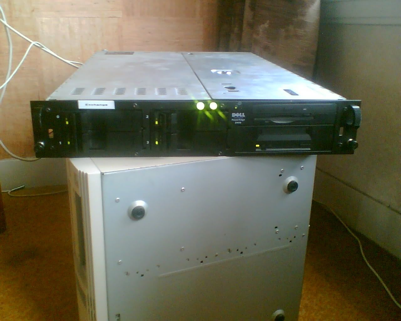

Fortunately I recently got another computer that can do the job and needs less (close to no) modding. I'm sorry to disappoint you with this news, but I have one small thing to make it up.
My new computer is a 2U-server, a Dell PowerEdge 2450, with 2x1000MHz PIII processors, 1,25GB RAM, 4x36GB SCSI HDDs etc. I'll show you one picture in this thread, and I'll create a new topic somewhere on this forum to show you everything (and ask some questions).
