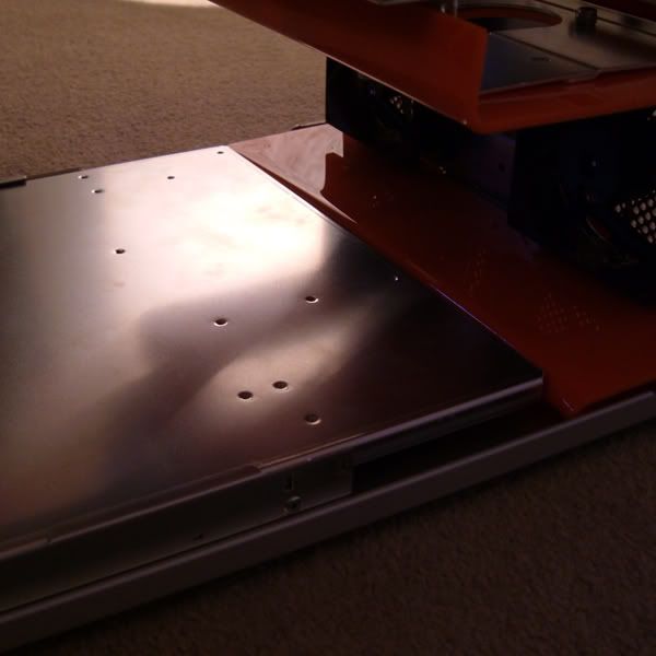

Next the side panels and motherboard tray:

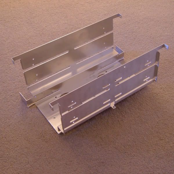

Leaving only the bracket to hold the drives. A few drilled rivets later:

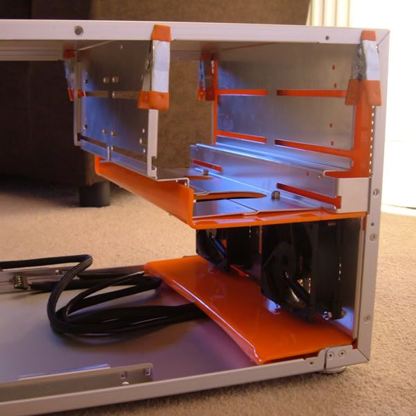

Now I can pass all the wires from the front fans and front panel through this junction box down to the case floor where they can be hidden.

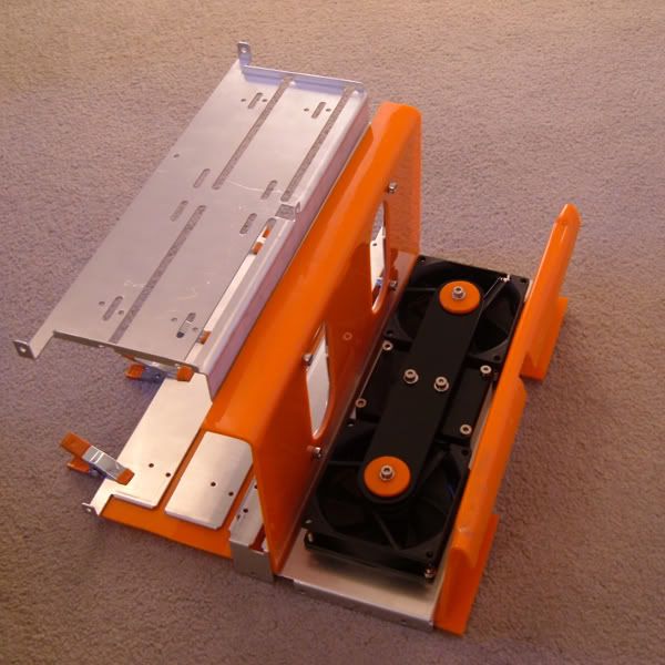

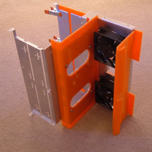

I have also sleeved the wires for the front I/O, I plan to have these hidden under a kind of ‘floor’ on the bottom of the case.
Acrylic
I am going to use a lot of acrylic on this build so went out and brought a scroll saw and a blowtorch to hopefully aid my cuts and bends.
Having never bent acrylic or used a scroll saw before I thought it best to have a practice first. So set about making a cover for the HDD bay.
I started out by drawing out the design and cutting it out with the scroll saw:
Then using the scroll saw as a temporary work bench, clamped the cutout for bending:
After a little heat from the blowtorch the bend was complete:
After cutting the edges were left a tad on the rough side:
So using 240, 800, 1200 and 1500 grit sandpaper I smoothed out the edges:
A quick test fit:

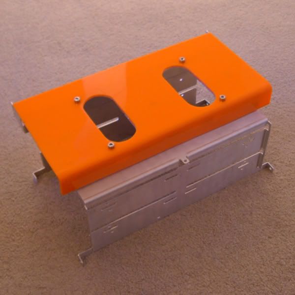

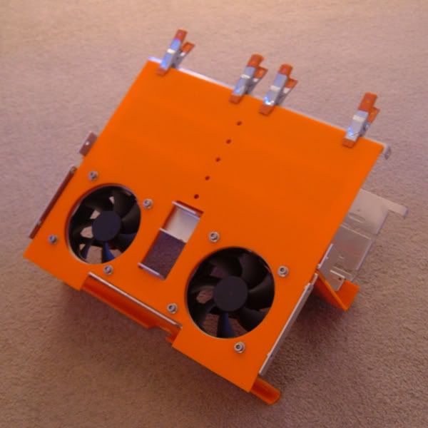

To mount the acrylic I needed two 4mm holes to bolt through, back to the temporary work bench:
Now to measure up and drill the HDD cage:
And using M4 hex bolts and some plastic spacers fit it all together:
Another test fit:
With everything fitting together nicely I removed the protective film and fitted the finished cover to the HDD bay:
The hole in the middle of the piece of acrylic will be covered with a sheet of mesh, so air will still be able to circulate around the hard disks whilst keeping the wires out of sight.
I am quite pleased with how it turned out, given most of the process was very new to me.
