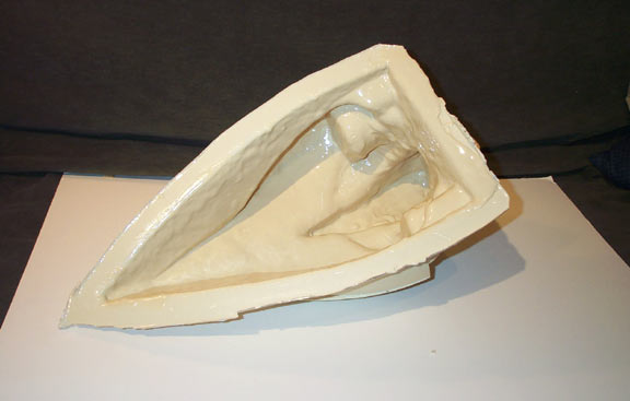

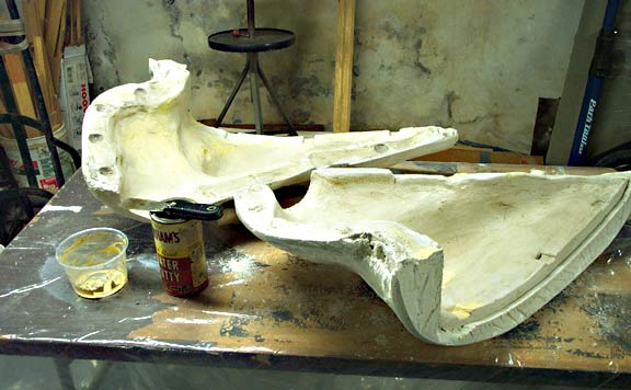

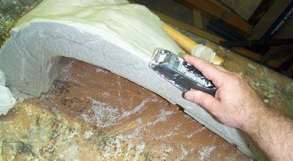

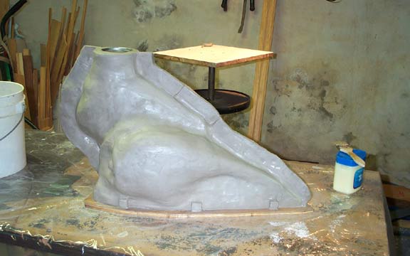

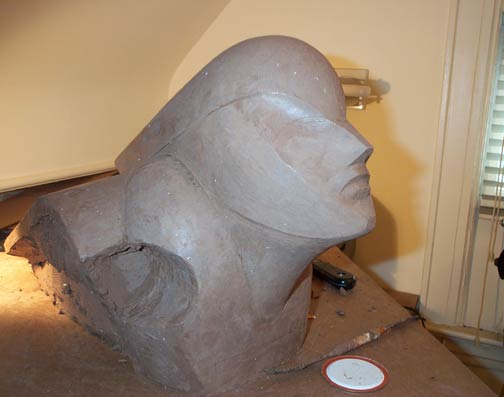

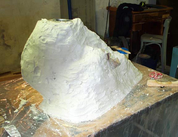

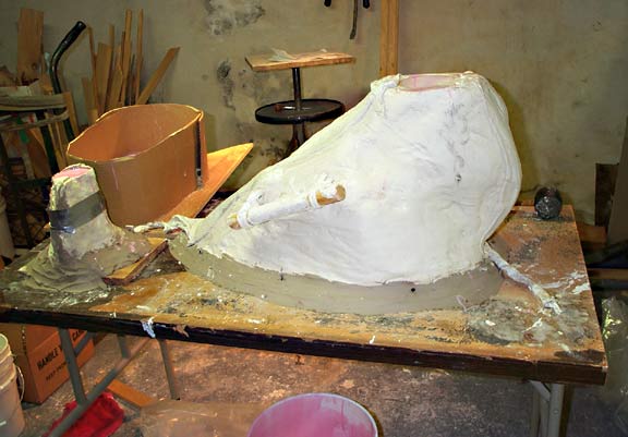

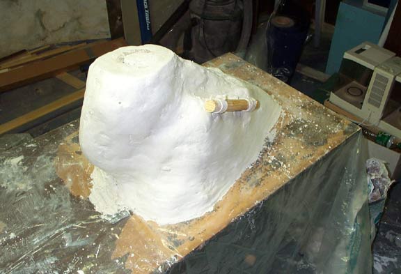

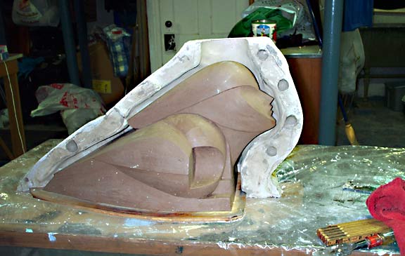

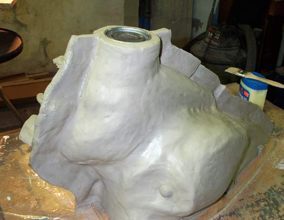

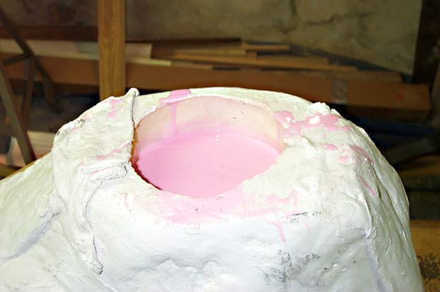

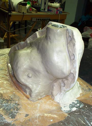

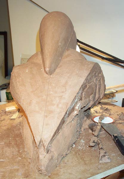

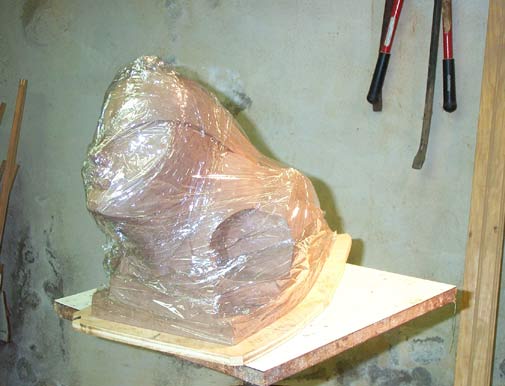

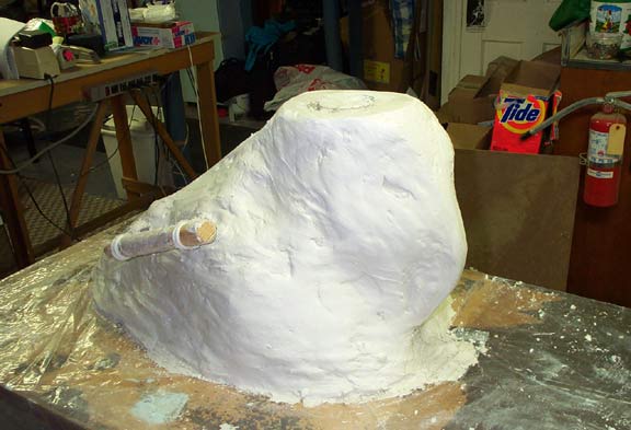

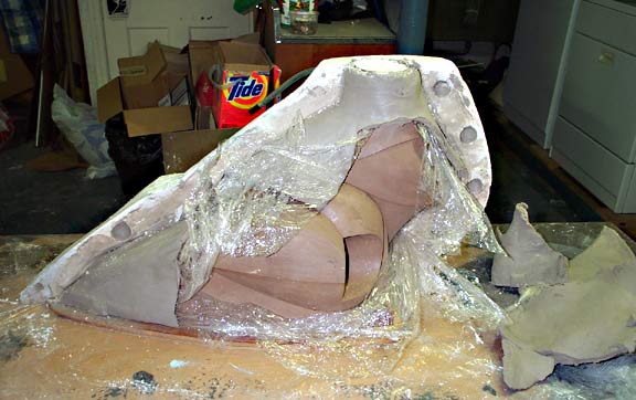

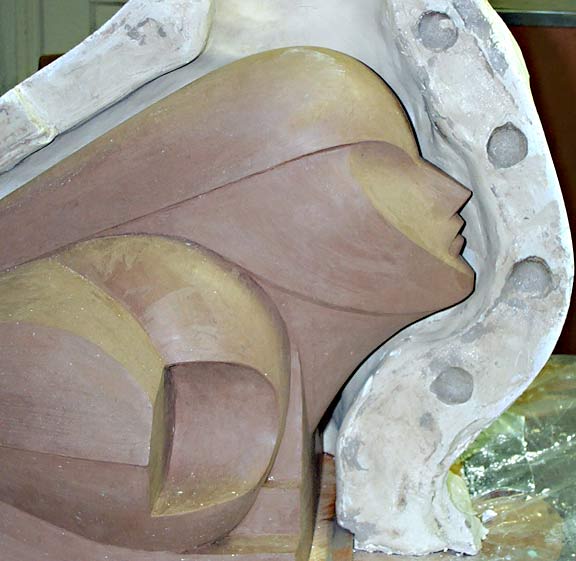

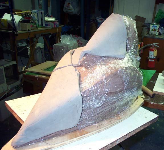

Wow, cool stuff. But darnit if I am getting a confused on the casting process...
Here is what I see, what am I missing:
creature sculpture
Add layer of clay
Create "mother mold" over clay
Break apart mother mold, remove clay.
Now you have a sculpture, and a mother mold, when you put the sculpture in the mother mold you have a space between them where you pour your casting material. but the Inside of this is detailed(against your sculpture) whereas the outside against the mother mold is not precise(as it was just your clay spacer).
Somewhere I am missing where you create the inverse detailed outer mold to pour the casting material into. Sure you can cast into the space between your mothermold and the statue and that is your new mold to pour a material into, which would thenbe detailed, and you discard this interim step mold, I just don't see you describe that above. (I really just want to understand your process, I'm not trying to be difficult ;)
Also It seems like the process you describe above requires a lot more steps than just making a mold directly off your initial sculpture, I was wondering why you choose to go the route you choose. (was it material restrictions, desire to be able to make more than one piece, etc..)
EDIT: ok I went back and reread everything again (4th time) and I think I might have caught why you did this. It sounds like at one point you talk about a silicon rubber mold, so I think the steps I donot see are the silicon rubber molded into the area where the blanket was. but then it looks like you skip to where you have taken out the whatever material the final is made from out of the silicon mold. or shoot am i just getting more confused....
Re: Intel's Silicon Rising
Read This Tutorial on mold making, it's the same exact method I used. ;)
Oh sure now you post this and I have half way through making a mess with one of my projects. (Having a bit of problem with mold release and Epoxy sticking to each other when they shouldn't be). :D
I have a bit of reading to do tonight when I get home.

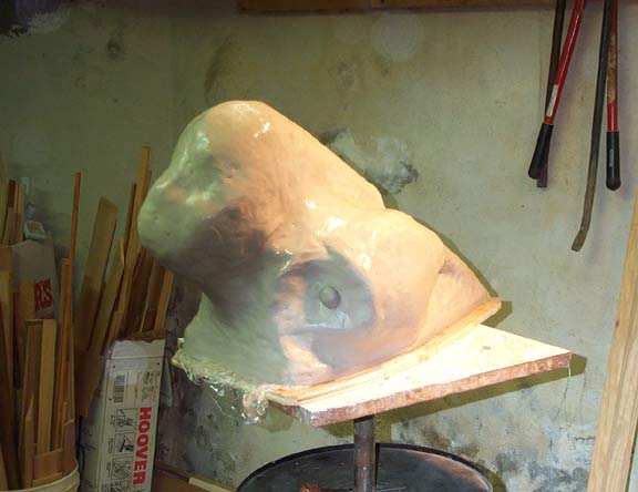

Been a while since I've posted here. Paul, thanks for the tutorial. It's not much different than some of the books I've read, but then again my books don't cover projects on a large scale like this one.
I must ask you, by the way: how do you mix your silicone (other than very, very well)? Do you use some large stir stick, or a spoon? Or is there no spoon? :D
Just wondering because I've had some moderate success with my silicone adventures, and not all of it cured (still hasn't, months later lol). I know why some of it didn't (sulphur clay in some parts of the model), but I'm wondering if other parts didn't cure because I didn't mix it well enough. I thought the colour was uniform. This stuff is expensive, and I'd like to avoid wasting anymore.

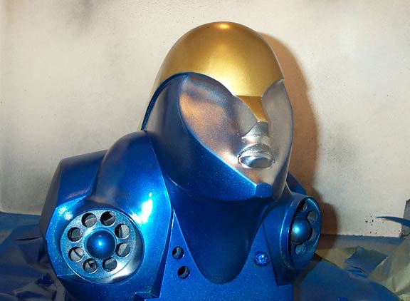

How did you do the silicon crystals? It's not SiO2... I'd be interested in knowing, for my own edification...
Kayin, the crystals are actually cast acrylic pieces of fake ice--the kind used for food commercials and photography :) You can get cubes, shards and chunks. They are pretty inexpensive when ya buy a big bag of 'em.
