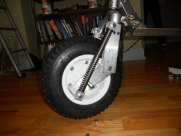

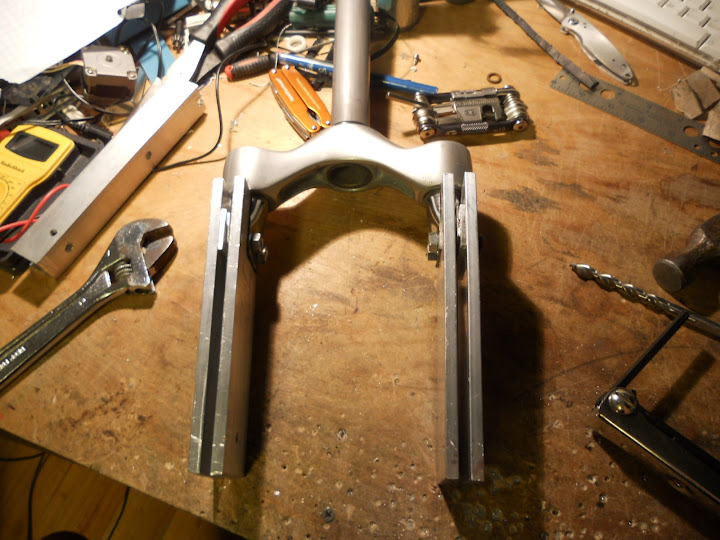

The fork had to be completely rebuilt as well. I started out by taking apart an old mountain bike fork. I removed the springs and dampers from the legs of the fork, and cut off the legs. In their place, I bolted pieces of 2" x 1/4" aluminum, to create a leading link type suspension. I built new shock absorbers out of steel tubing, steel rod, and the old springs from the mountain bike shocks.
MTB fork on the scooter:
DIY shock absorbers:
Fork:
With a wheel:
I cut dropouts for the wheel, so it can be removed easily (I did this on the back as well, but don't have pictures right now):

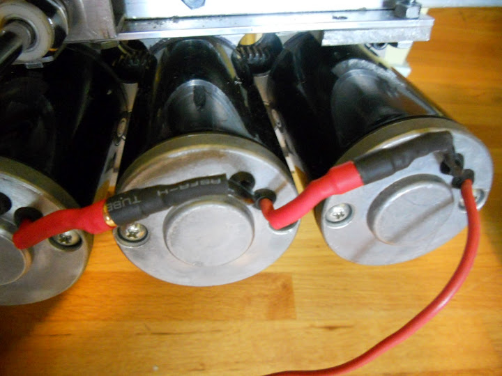

Now for the motor assembly. To power this vehicle, I am using 3 2.5" CIM motors, which are the standard for FIRST robotics. At 12V, which is the limit at FIRST, they only put out about 340 watts of mechanical power at their peak, which isn't very much. I'll be running them at a little over 18V, so I'm estimating that I'll get approximately 750 watts out of each motor (1.5x the voltage, 1.5x the current) That means I'll get a total of 3 horsepower. Now, I could buy a cheap brushless motor and get twice that for 1/5 the weight, but then I would have to actually buy the motor along with a motor controller, and from what I've read, hobby brushless motors/esc's are extremely finicky in personal EV applications. For motor controllers, I will be using 3 IFI Victor 884 controllers. Although these are listed as being max 15V 40A controllers, they are in fact underrated. They are identical except for the microcontroller to the older Victor 883 controllers, which are rated at 24V and 60A. So they should be fine at 18V
Since CIM motors are high speed (about 450 rpm/volt), I built a gear reduction out of two gear boxes I scavenged from school. The gearboxes were originally 2 stage, but I removed the second stage, as there will be additional reduction from the chain drive. The original gearboxes were designed to hold 2 motors each, but since I am using 3 motors, I chopped up the gearboxes and spliced them together into a 3 motor 14:50 reduction. I fastened everything together with this stuff called Alumaweld, which is basically a brazing material that works on Aluminum.
Here's the gearbox:
Here is the inside. I still need to buy one more 14 tooth motor gear:
The whole unit:

Both the forks are made from 1/4" thick aluminum. The plate used for the rear forks is 4" wide, and and the front is 2" wide. It should be way more than strong enough, especially since I weigh under 140 lbs.

Not sure about the geometry of the front end. Since the wheel is forward of the center of turning, it's likely to want to swivel around 180 degrees (like a caster on a shopping cart). I would at least add some width to the handlebars to help counter that. Still, just looking at it scares me. I had a gas powered one that somebody gave me. Sold it once I got it working. Too much likelihood of eating pavement real hard.
04-02-2012, 08:54 AM
Technochicken
Re: Off Road Electric Kick Scooter Build
I the low-speed tests I've done, the steering geometry has not been a problem. Because of the kick scooter frame I used, I had to choose between having a decent amount of suspension travel and having the wheel set back closer to the steering axis. For better or worse, I chose more suspension.

After a lot more thinking about how I could relatively easily change the fork geometry to improve handling, I went for it and rebuilt the fork. Steering feels much better now, and I did not have to sacrifice any suspension travel, because I just increased the clearance.

That steering geometry looks a whole lot better now. Now all you need is a good motor driver and you're ready to faceplant with the rest of the kids. I wouldn't ride one unless I was wearing a football helmet and full riot gear.

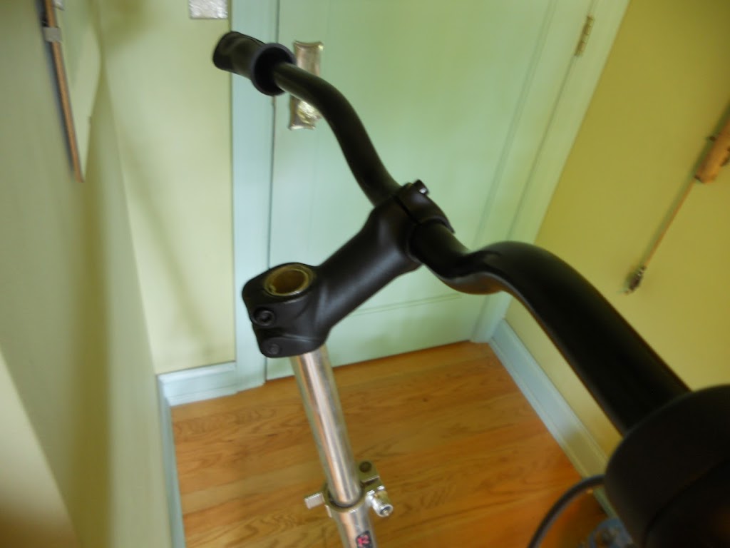

I replaced the handlebars with the bars and stem from a scrapped mountain bike.

I wired the motors in series, using some large bullet connectors, and added screw terminal connectors to the first motor's positive and last motor's negative, to connect to the motor controller. I soldered a solid copper spacer to one (salvaged from a heatsink), so that I could connect the terminals parallel to the top of the controller:
