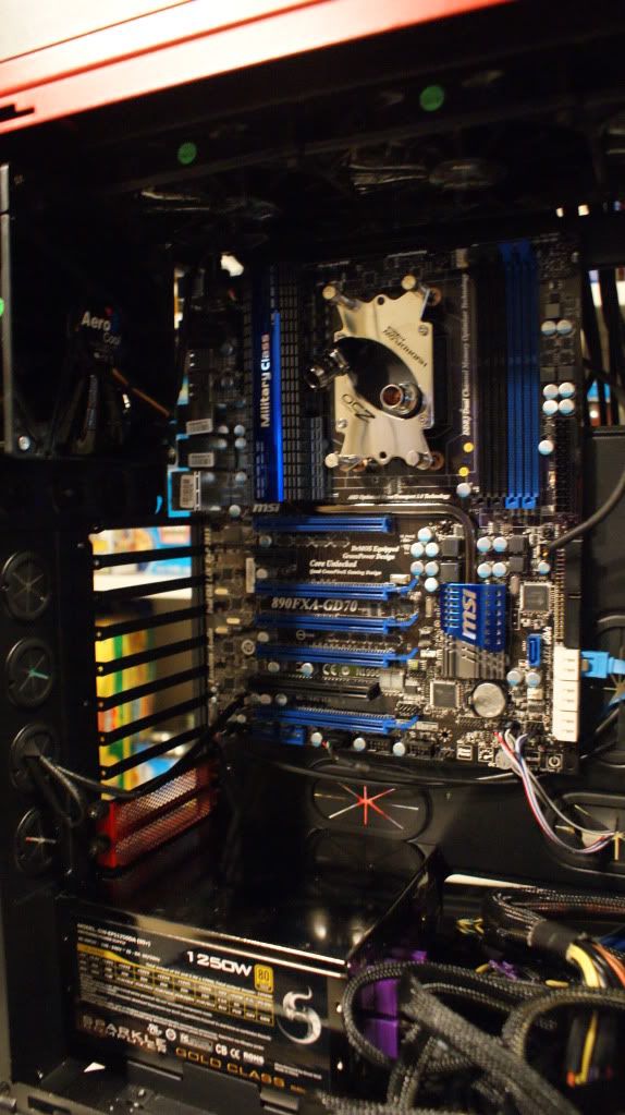

Next installed the motherboard and PSU.
Attached the 2 fan bus' and connected all the fans. I wanted it to look cleaner but its hard with all the different lenghs. The side closes with no trouble so I guess thats a win.

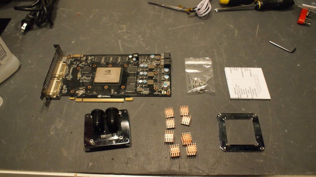

Also... I lost a GPU. My 3rd Galaxy GTX460 died somehow. Not sure but I might be screwed if I can't get the invoice from the eBay guy I bought it from.
But some good news! I was going through my boxes and found another GTX460! Its another EVGA GTX460 SE.
So I am going to add it to the loop. Here are all the parts it takes to water cool the GPU using the universal GPU block.

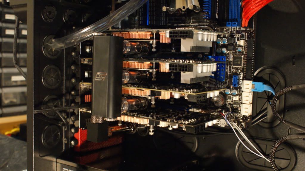

Here are 3 of the cards connected to Tri-SLI bridge.
Now for the last GPU I had to get "fancy". I took a 10mm male/male extension and attached it to a cheapO Danger Den 90 degree fitting. Then I made the connection to the GPU using an extra SLI fitting I had. The result was actually really really good. The port that isn't connected yet will be connected to the pump eventually.
All 4 cards!
