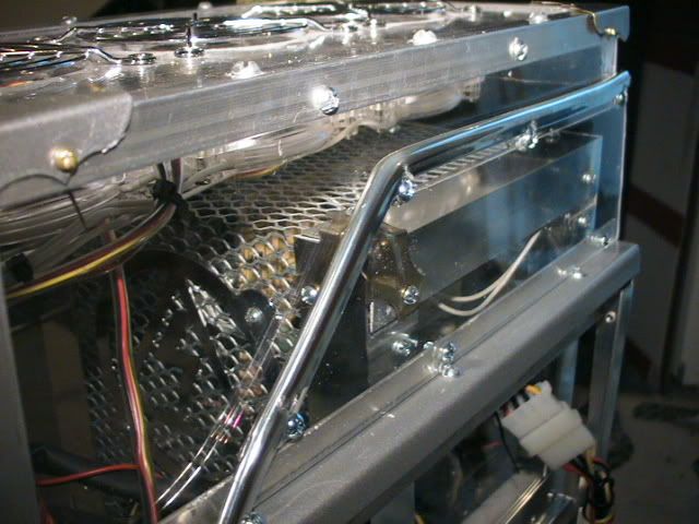

After a little talk with jdbnsn, I've decided to gave a second live to an old mod I've done a long time ago.
First the build of the casing
Mesh on the front and top, plexi on the sides
and a 120mm at bottom
inside view from the rear
outside view from the front
Then I put the 2 PSU back to back with a plexi plate in between
And fit them inside the case, passing the wires in the holes
Add a round ccfl on the 120mm fan
and finally build the back plate for the PSU with 2 Blue leds 80mm fans
as you can see, it needed 2 wires connections, I could have put only one, splitted inside the case. But only a dual switch was needed.
The final piece with a laser cut grill to prevent for electric shocks ;)
Inside the case:

At that time, the bigger PSU was at 420W I already had 6 HDDs, alot of lightning (wich I dont have anymore) more then 15 fans alot of OC. The second PSU was for the fans and lightning

This is done by connecting the Green wires on each power supply and the ground wires on each power supply. If I remember well, it's the 13th pin for the ground and the 14th for the power. Just google it, There's a couple of site that explain how. For my part, I cut all unwanted wires on the second PSU

As for the fans, what's inside the PSU is just a couple, With the mesh on top, I add a couple there too
