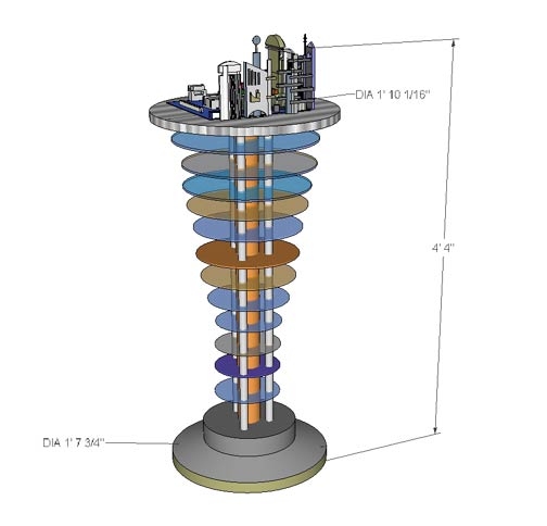

The first renderings show an early version created in Sketchup, and little has changed except for the dome and placement of the buildings around a circular form. Thanks to Mashie, who during his visit in the US recently, helped me with the design and construction of the city.
Plexi circles in increasing diameter will be cut in translucent smoked 1/4" bronze Plexiglass material. The center tube is frosted acrylic, and will hold 3 CCFL Green lights along its length from base to top. The top and base will be made from 3/4" MDF and painted.
The three smaller diameter tubes are aluminum electrical conduit that will be brushed and polished, then sealed. Each plexi circle will be attached to the three alum rods using black rubber O-Rings.

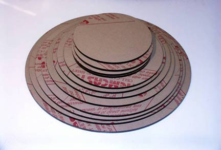

For the pedastal I chose a translucent smoked/bronze ChemCast plexi. Here are the 1/4" thick pieces back from the laser cutting service. The next step is to cut my holes in each for the tubing and pipes. Should have pics up of the pedastal assembly soon.
