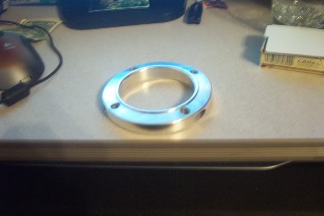

hey TD...kinda late in the mod to offer...but i just realized i had these around
its part of a floor mount we make at my shope.... he have a few scrap around.... but they are roughly the size of a 80mm fan...and with a bit of modding...like say a plate to match up holes....it is able to fit a fan
wow, those look great for fan mounts/frames
That they do.
Pretty cool, b4i7! I may tak you up on some of those on my next build. 80mm fans galore! ;)
