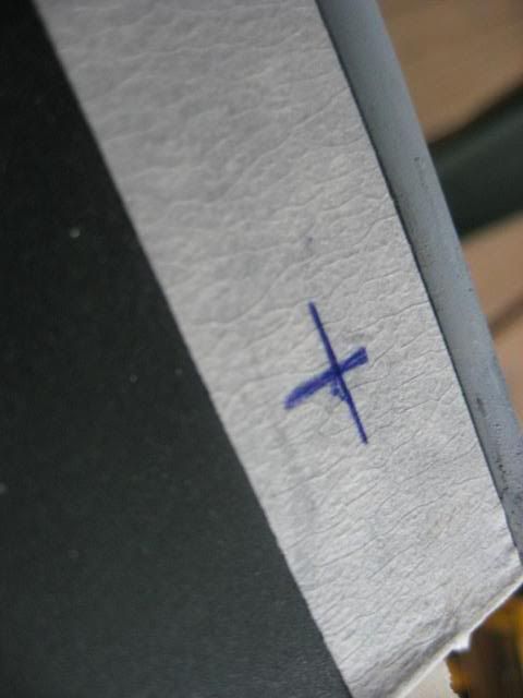

OH I finished the back door.
I started by evening up the door to the case as much as possible. Its close enough. I also had to cut off two rivet heads on the left side of the case so i could attach the hinges.
After they were cut, I taped everything up to mark the holes and then drilled.
Before I attached the door, I wanted to cut a small hole in the bottom for air ventilation. So, I marked it off and then cut it with the handy dremel. I intend to put some mesh in the hole as well.
After that, I attached the door with the hinges.
I then marked the holes for the latches and attached them as well.
I then sanded and threw on some primer to protect the metal.
I hope to start the front tomorrow but that will be a challenge. I have to cut a piece out of another case to create a door for this one. O just hope I dont screw-up the measurements.;)
Thanx for looking,
-danthegeek
