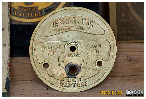

I've tried the Birchwood & Casey Brass Black with mixed results. It's fairly fragile and wears off if rubbed. I used the solution, and then coated it with black patinating wax. The meter case looked fairly good but the etched plate lost too much of the patina when I buffed it.
Attempting to mask off the patina with tape lifted the patina on the case. Sorry no pics before.
Looking at the remaining patina around the mounting stud. You can see it was fairly solid and even.
I'm looking for a solid background for the etched plate hence my efforts with the scale coat.
I'm waiting for a decent stretch of weather (high temps and low humidity) as the technique that I'm attempting oxidizes the brass quickly. It uses a salt crystal mask to mimic chipped and weathered paint so it has to be painted right after application.

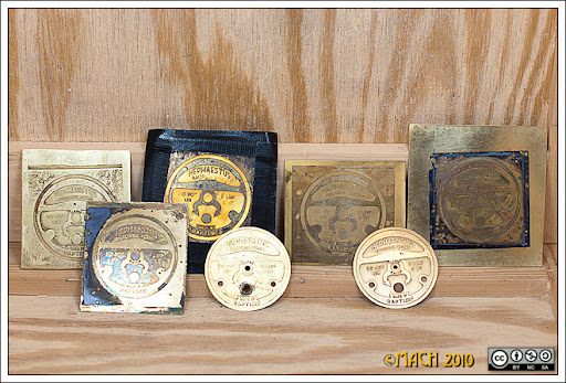

I had been working on the meter painting but haven't much too show except for repeated fail. I must have stripped and re-painted the meter case 5 or 6 times. I also tried patina wax, liver of sulfur, and Brass Black.
I tried it so many times that the combination of ph Down and peroxide that I was using to remove the oxidation and put tooth on the brass started to etch the detail away after repeated dips.
So I took it as the opportunity to fix a couple of problems with the original face like the solder mess around the bezel. Unfortunately, it took a couple of tries. I tried electrolytic etching with copper sulfate as well as Sodium Bisfulate and peroxide but found the best etch was consistently with peroxide and muriatic acid.
The press and peel blue really gave me grief this time around but the addition of laminator soon fixed that too. This is a Royal Superguard Laminator Plus model. A little modding makes it perfect for etching PCB and brass sheet.
Opening up the laminator, see the resistor? A quarter turn there and the laminator heats up to 200F and works wonders for getting a good transfer after about 5 passes through.

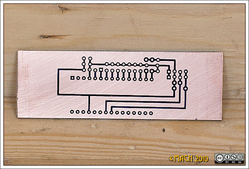

But the case said redesign for size. Here's the second version (pre-etching). See how the toner transfer held up? Only a few small touchups.

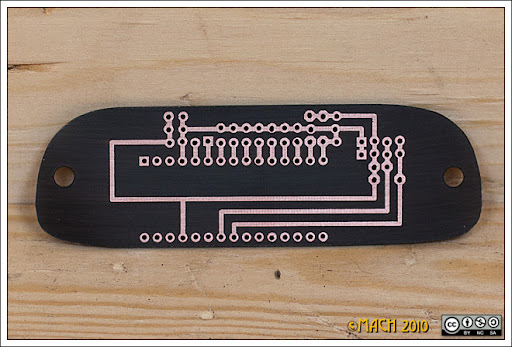

And after etching and drilling. The black was done using fabric dye.

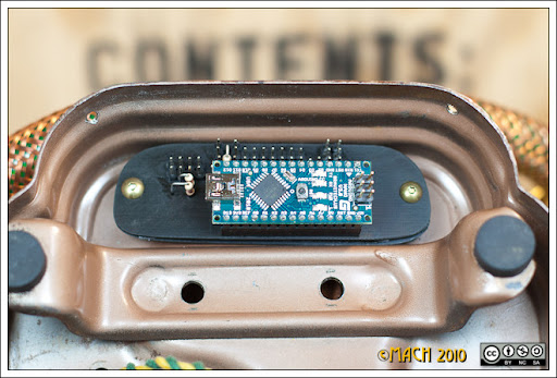

But that's for another day, here's the circuit board mounted on the base of the case. I put a piece of black styrene on the back side to avoid any shorts.
This will be where all the non-essential wiring terminates.

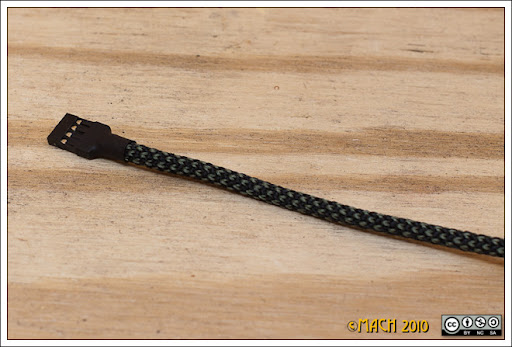

Up next is the case wiring and sleeving. Anyone ever experimented with using para-cord for sleeving?

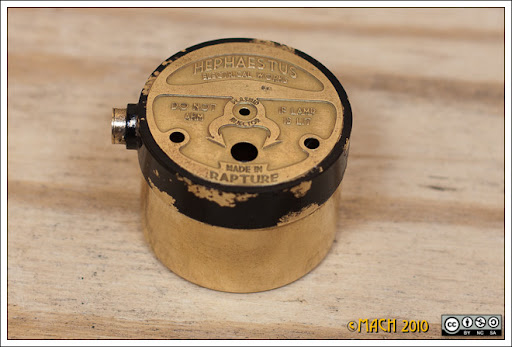

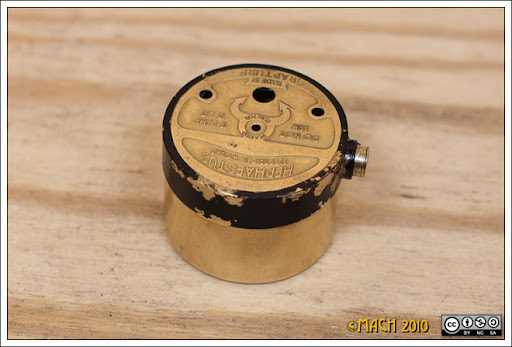

To bring this all full circle, the meter. So today the weather finally cooperated for another try at the meter. Instead of trying to paint and then weather it, I'm doing it in stages. The first stage is the chipped paint on the meter case using this technique.
http://www.scalemodelguide.com/guide...lt-weathering/
Masked for painting
Margarita salt applied using a paint brush and water
Airbrush treatment and an hour baking session in the the paint oven. Chipped paint effect.
Next up is to paint the face using a very small brush. Here's the new bezel in place. Instead of soldering it, I made the bezel so it won't fall through once its mounted.
