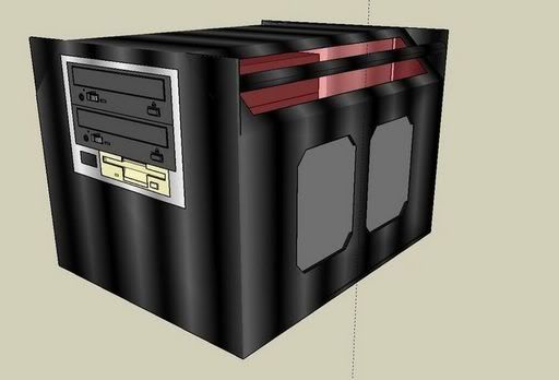

Given the newer, free-er version of Sketchup, I got to work:
My first draft, using the website dimensions, and some guessing--
My second draft, after I selected Black exterior with Red hardware--
I then added red plexi to my crescent/sword motif--
That seemed a little flat, and I was Googling some Crescent/Moon/Blood/Sword stuff and I came across the idea of the Blood Moon: NASA on the Eclipse in 2004
So, after playing around for, oh, 10 hours or so (had to learn how to make spheres with the "follow me" tool), I changed to this--
The larger Spheroid represents the earth, and will be blue plexi, 6" across, etched and frosted to look like the planet.
The smaller Spheroid represents the moon, 1/4 the size of the earth, and will be clear plexi, etched and cratered too look right.
The V shape is the refracted solar light that makes the moon look reddish.
I don't know if I will do the top one yet: it makes the case look like a warp drive, or engine of some kind...I don't know why my brain thinks that.
Comments?

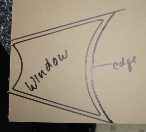

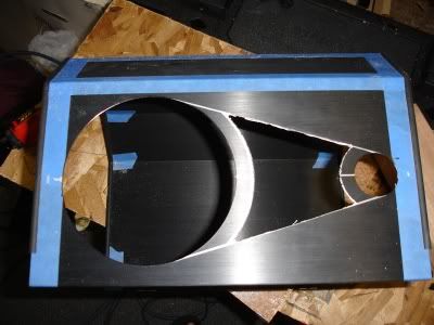

Update: decided to work on the red window between the two domes--
a quick trace gives me the shape
have to buy new Radiosh--- needle files, I can't find my old set...so those corners will get cleaned up and painted black to hide the silver.

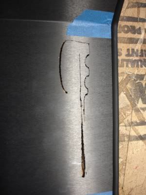

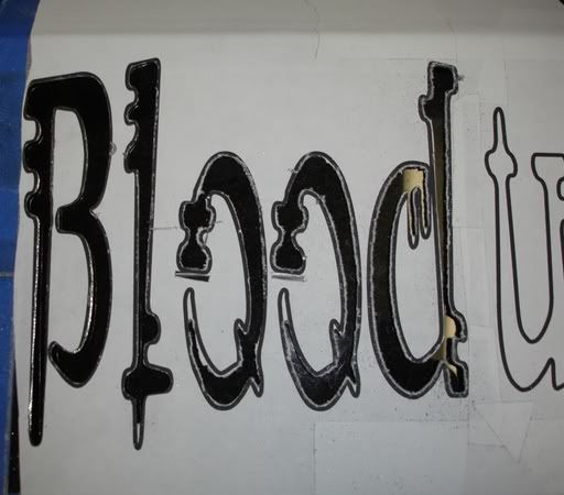

After fiddling around to get the letters the same proportions, I printed my letters onto while full sheet label material (so its stick all over).
I prefer full sheet adhesive since it won't move while you work with your dremel.
I cut little marks through my sheet so I could see my centerline, and laid it down directly onto the shell of my Qmicra.
Then I went around my first letter (I prefer to cut INSIDE the heavy black line) just to have a guide for my 1/16" carbide bit (actually meant for Grout removal, smallest I could find).
I then went on to start the slow process of working my way through the metal, little by little.
You can see on the backside just how narrow the cut is. I like to use nail files and such to finish the edges...this process leaves very little rough edge, and just a nice smoothing makes it look very finished.
As I move around the edges of my first letter (B) the support I have for my hand, and the angle of my tool slightly changes how the cut is made.
I have to consider when my center part will be free so I cut on the other edges to prevent putting weight on the most delicate section the letter.
Here is another look at the backside. The cut track is only about 1-2mm at its widest.
This is tedious work, but I already have one goof that I will have to adjust the shape of a letter. :x
By moving very slowly, in areas about 3/8-1/2" at a time, I can control the cutting path precisely. I much prefer to file a little longer in finish than to scrap the whole top of my very expensive case.
My first whole letter, cut!

Working some more this morning, got two more letters done:
And a look at the inside:
Then, I stopped off at the local pharmacy's manicure section for some of these:
Which I find are very useful in detail filing, and they are a whole lot smaller and cheaper than regular files.
got the whole first word done, and some of the filing started on the B and the L.
been doing some more filing, and to judge how well I was doing, I needed to take my printed letter mask off.
Ick, that adhesive only comes clean with citrus cleaner THEN paint thinner.
so here you can see it after clean up.
note the tool skips on the top of the B curve, and different part of the Os.
so I took a Sharpie PAINT marker, and just rubbed a little bit of black onto those little areas.
Up close you can still see the slight depression from the tool, but I'm not sure if I can really "fix" that.
These letters are about 80% of the way there IMO, some more smoothing to do, and small parts of the two Os aren't quite enough alike for my tastes.
Each cut is a bit better than the previous one, and my slow, tedious technique is paying off in needing only small files, taking a millimeter or so off at the most, and having the shapes well done instead of a lot of hard filing on the delicate section.
When totally complete, the silver filed edges will be covered in black paint too. Should make them appear VERY round when the only edge will be the light from below in red plastic.

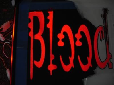

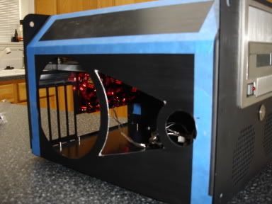

I just couldn't resist cutting up the red acrylic to do a lighting test:
not quite the result I had hoped for...but if I frosted the window (tested using a folded paper towel to simulate):

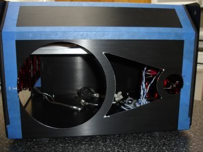

The lighting has really been bothering me:
stripping tubes out of ccfls proved risky at best-a waste of 2 4" tubes.
so I went and fetched some 5mm 30mA red water clear LEDs and a handful of red diffuse 3mm just in case.
My idea is that making a mirror box (like my lightpump in Lubic Zen-Feng) should reflect the light, even it out, and keep it from washing the whole case in red light. I think I will add a layer of frosted white to even it out more.
It's only 3/8" thick in total (using the score and break method was time comsuming) and covers the entire area that the letters on top occupy.
It has to clear the PSU and drive cage, and it will be attached directly to the shell so when I hinge it the whole thing comes up as one object.
the results (before the white acrylic):
Much better IMO, and I think it will do the job nicely. Some black vinyl dye for the back to make it look stealthy from the inside, and Voila!

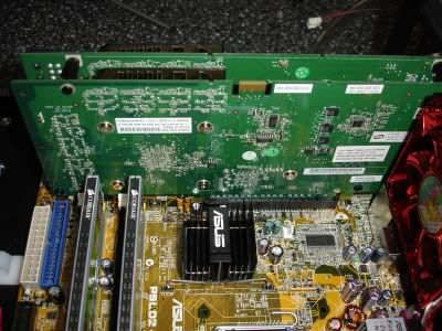

assembled the NV-7800 onto a gpu from another card...
and the fit problem with the waterblock:

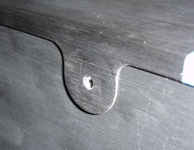

worked on my idea for new handles on my Qmicra
I wanted more clearance to actually USE them as handles...
here is the first one before little files
after little files
it locks down tight enought to pick up the case (with mobo, GPU, DVD, and RAM) without rotating out of place!!! )) Me likey.
I will eventually get them anodized red along with the PSU tray, radiator brackets, etc.

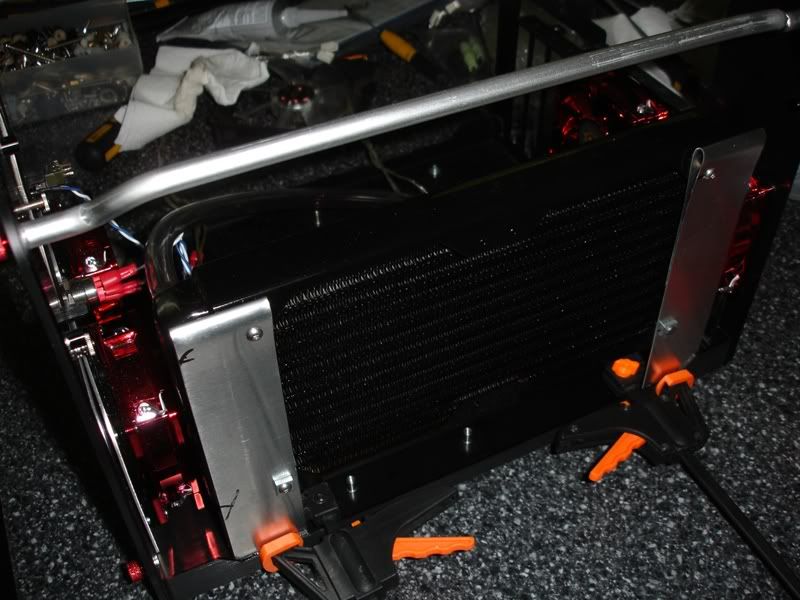

today...I mount the radiator! Just HAVE to be sure it will fit.
Stopped and got some strips of 20Ga aluminum sheet, 1.5" wide at a local hardware store.
Some measuring, some bending, some folding, some dremel work, some drilling, and some E-6000 adhesive gives us this:
those ugly cuts will actually be UNDER the motherboard, but I will probably cover them with red acrylic anyway.
it's light, a little flexible, and holds it nicely. The only thing is the tubing has to cut through the 3/5" bay, but I'm not gonna use it anyway. Maybe some switches for my special LED controller....hmmm.

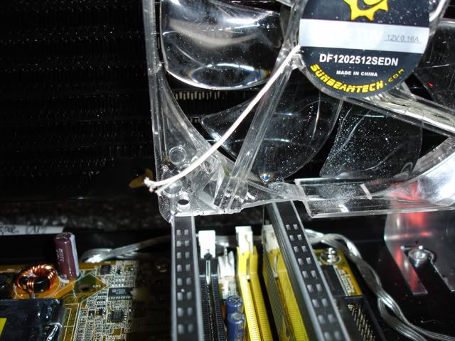

I thought I would snap some closeups to show just how tight the overall fit is should anyone else want to cram watercooling gear into a Qmicra:
I figure the TDX will sit with the barbs perpendicular to the radiator
the tubes will run like in my Loch Ness case shown here:
Here you can see how close the fans sit over the RAM. I know the whole fan won't sit over the radiator, but my guess is the cooling loss will be negligable.
This shows how closely those Radiator brackets sit to the rear 80mm fan...I might actually lay a thread of adhesive on the fan to further brace it from rubbing and hold the Rad in place better.

I also fiddled with getting the fan put on my Radiator, and I knew the RAM was too high, so I did this:

and it works! Just as predicted.
Some movies:
6Mg of just the lightbox
11+Mg of the lightbox under the lettering
