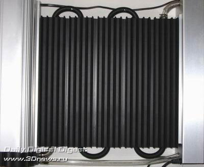

This assembly is the radiator. It'd have large fins sticking off all the sides like the radiator in the pictures above, It'd also sit OUTSIDE the computer chassis under a table, in your fridge, sitting in a bucket of ice or what ever you wanted to. You could even attach fans to it like a classic radiator.Quote:
And what do you do with this enormous amount of heat you extract? You're going to need a BIGASS radiator and that would preferably have some auxillary cooling too. Else, you're just pulling all that heat out, and dumping it straight back into the system!
If you look at the 2nd diagram you'll notice that a smaller fractal radiator is put after the res and single pump.
