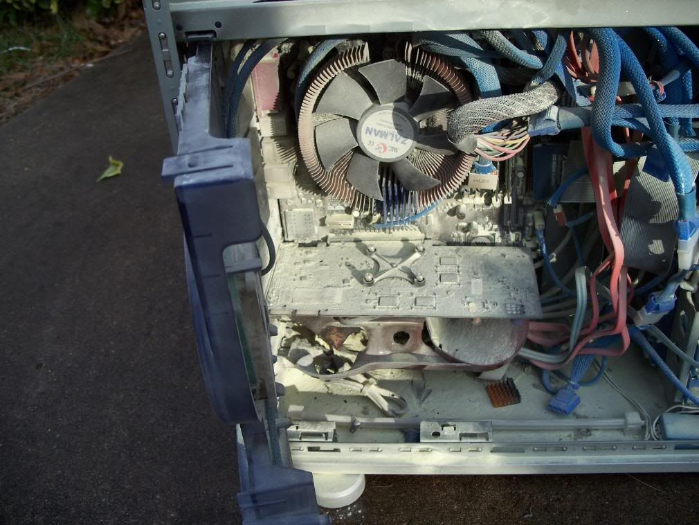

    First just a little back story on why I needed a new PC. My last one burnt up and was put out by me with a fire extinguisher after running 3 weeks with a new raid card and vid card.
    So the first pic has the melted vid card and the second shows the fried raid card after removing the vid card.
    So I want/need a new computer.

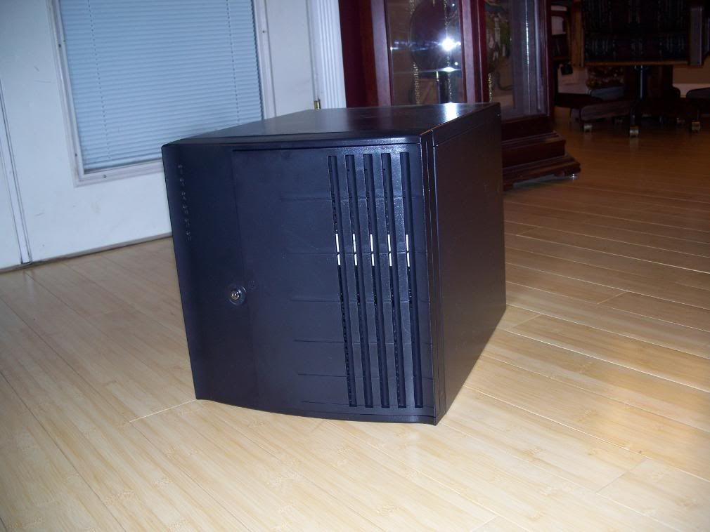

    The new case!
    the White you see through the slots is my dvd drive from the last PC (may it rest in pieces) I intend to replace it later but not yet.

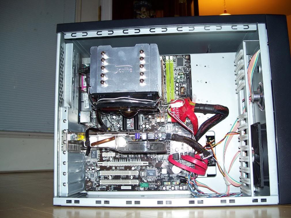

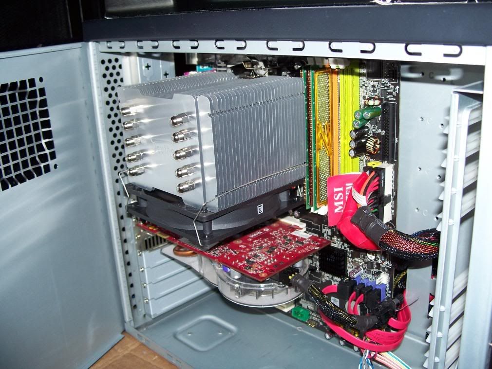

    so a little closer shot of the insides.

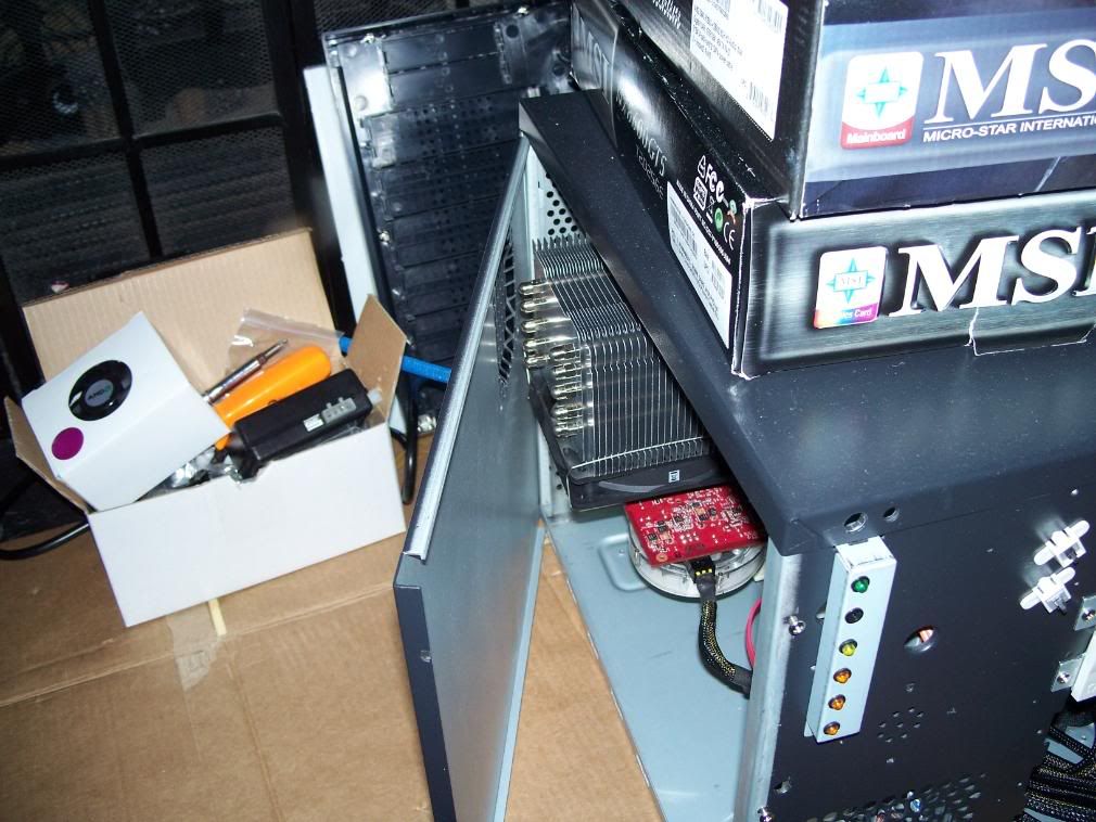

    I quickly realized the scythe CPU cooler was too big for the case.

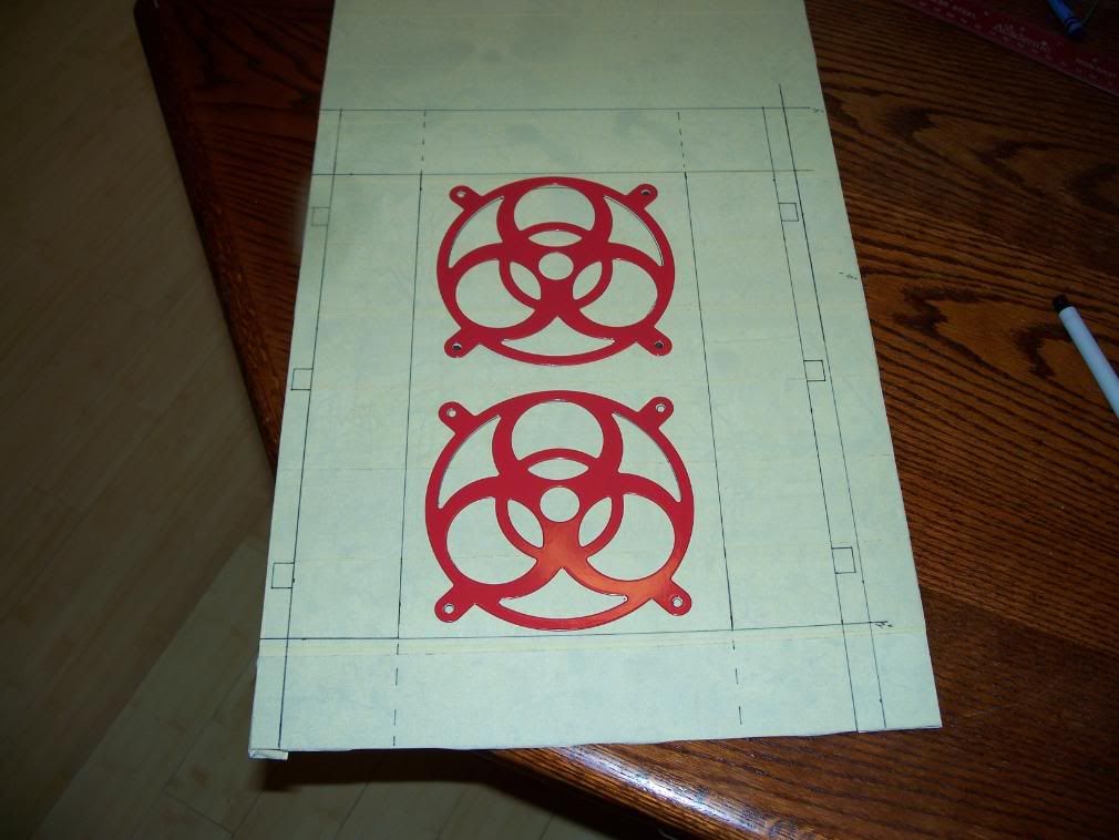

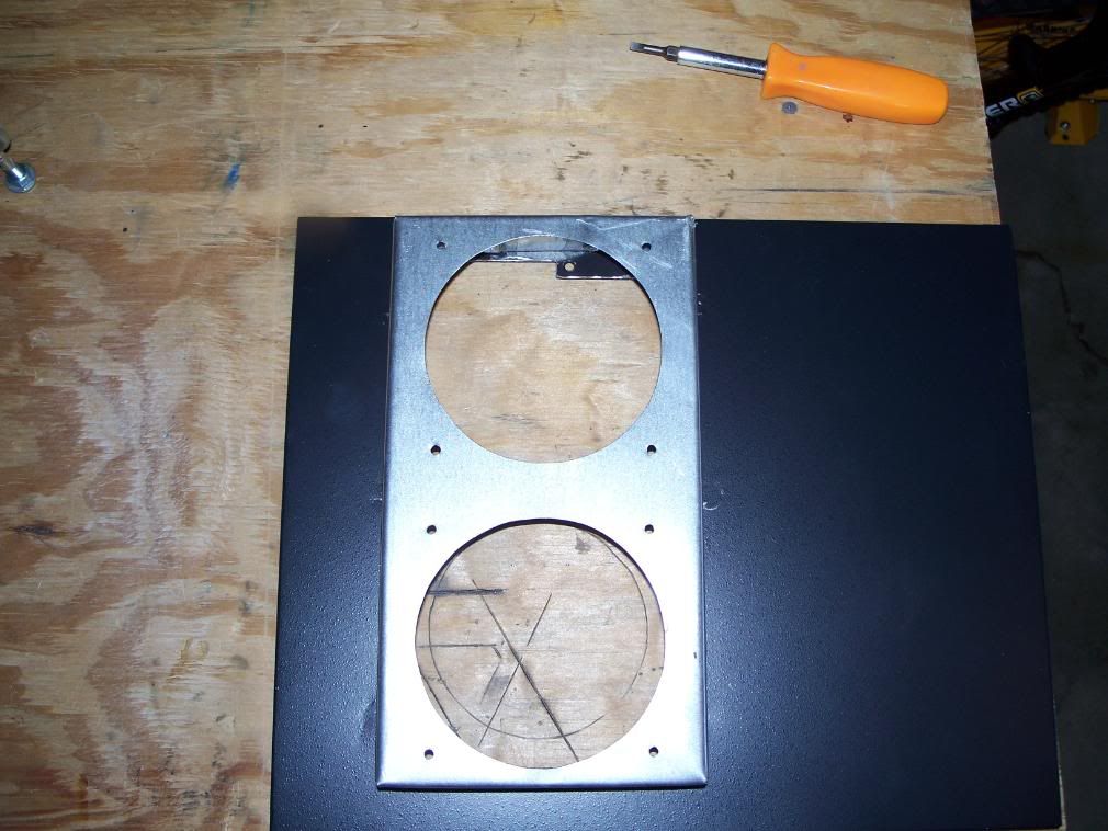

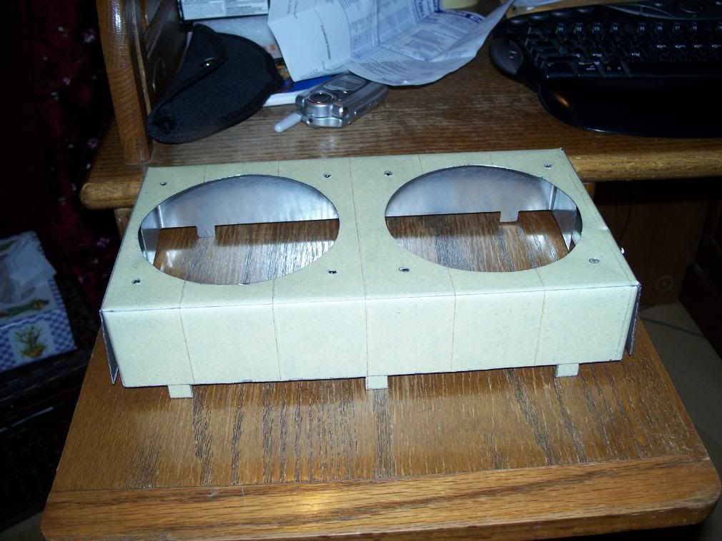

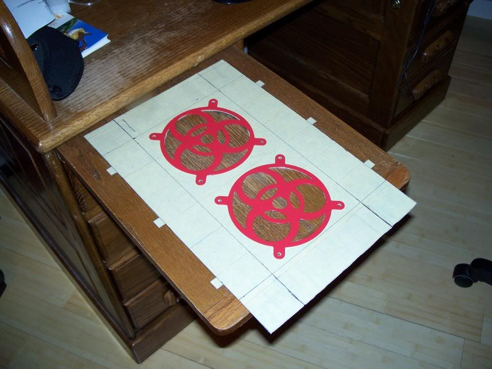

    couldn't get the side door to close! It sticks out like an inch too far! So I need a Bump out to cover it and since its in the way of the side fan might as well incorporate a new fan as well. So a quick run to the hardware store gets me a new piece of sheet metal for only $5.06. Now at home I go ahead and tape it off and mark out the cut lines.
    and some fan grills to show a little better how it should look finished.

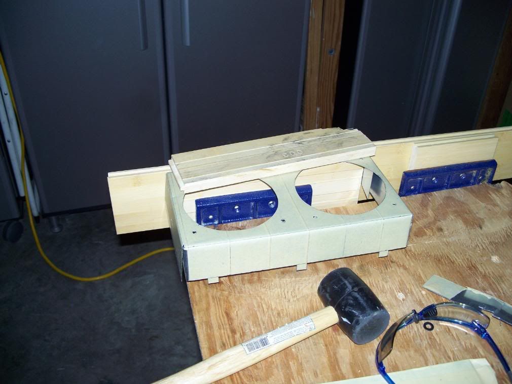

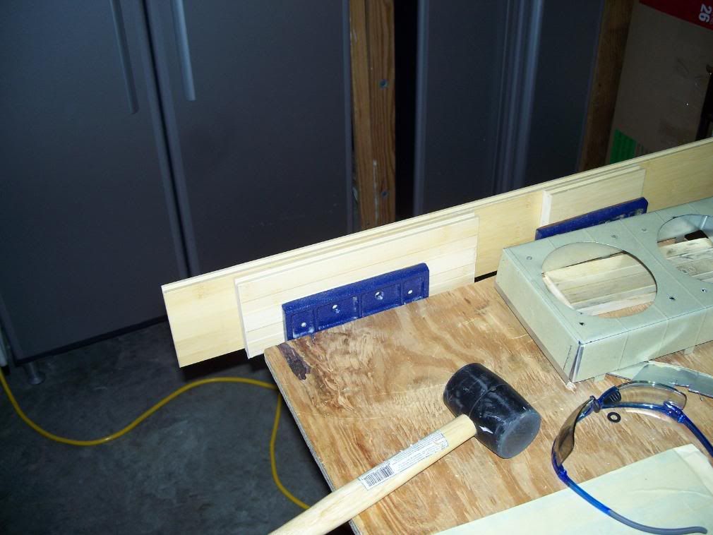

    Ok all cut and ready for bending. so a shot of my bending machine.
    and another with the bent box in place to give you a better idea how it was done.
    Bent into shape, but still needs glue to hold the sides in place and a little TLC from a set of files.

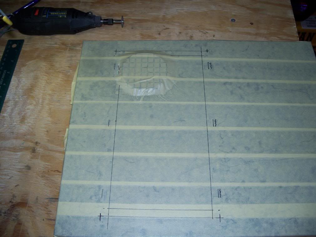

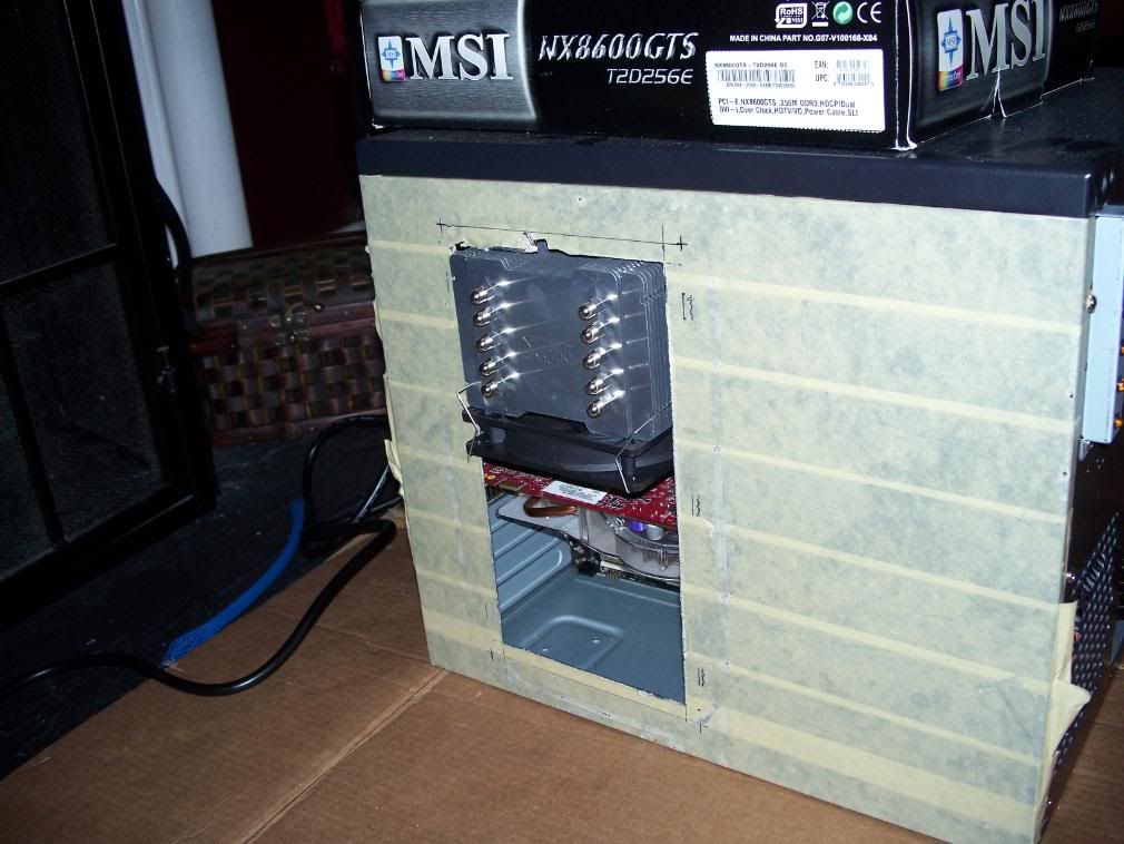

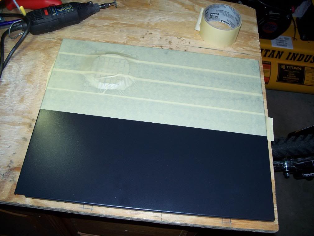

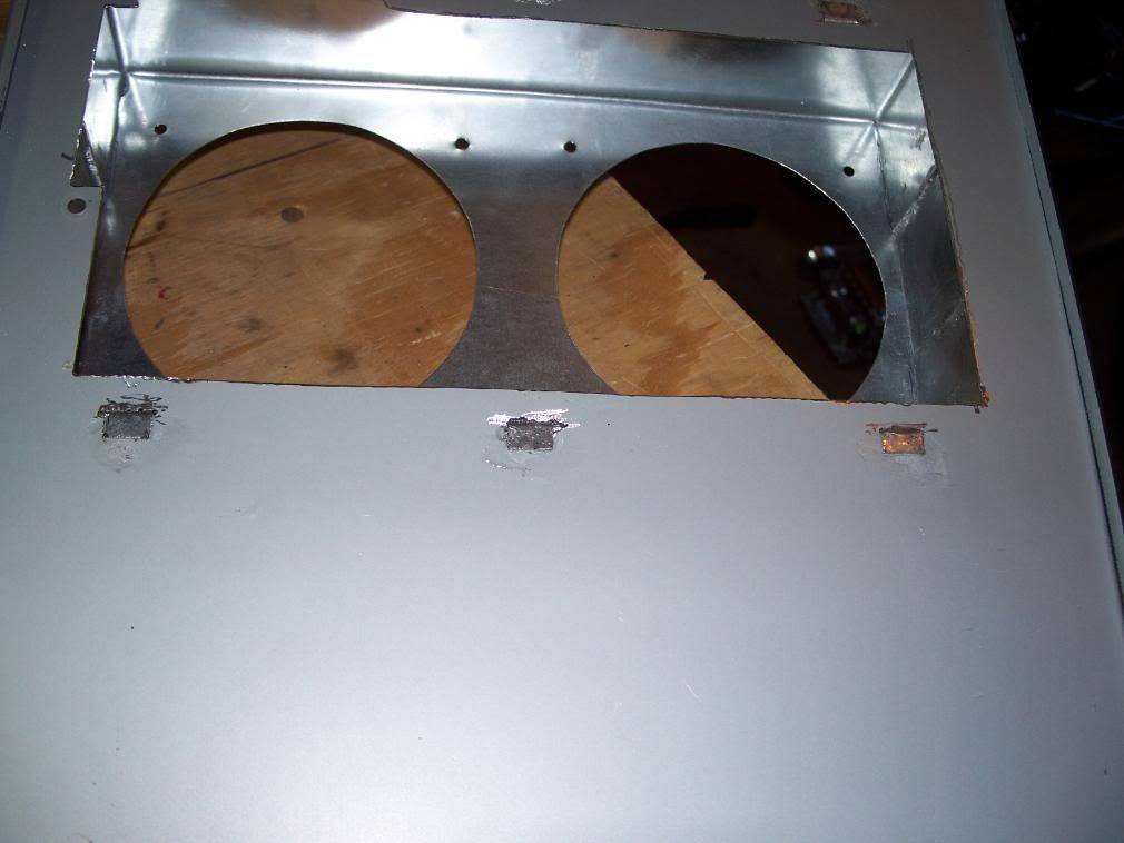

    So now to start on the cut out from the side door. first a Little tape so I dont muck it up too much.

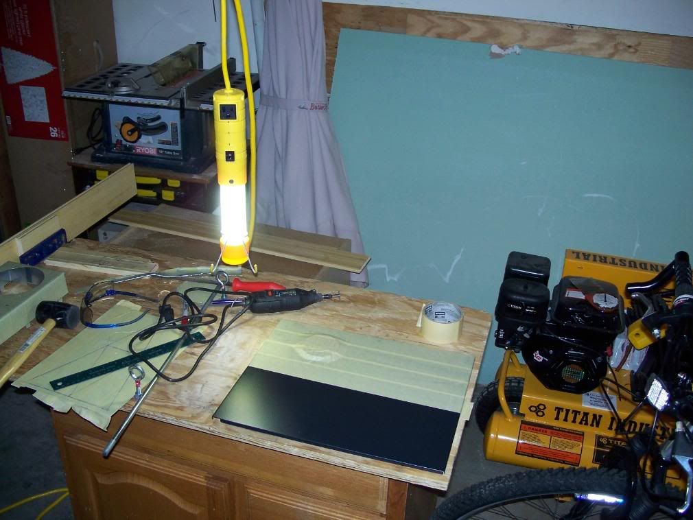

    and a little shot of my work area/ garage. and yes that is the main source of light for now.
    All taped up with the cut marks layed out.

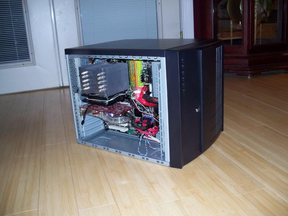

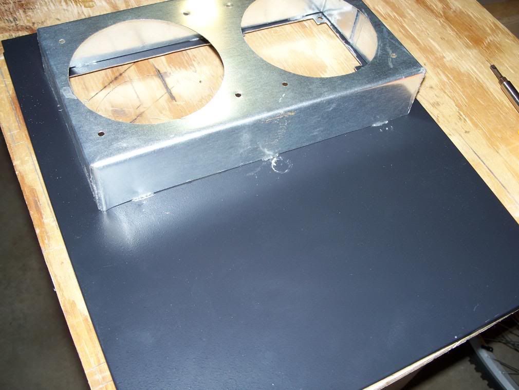

    and the test fit on the case. fits!

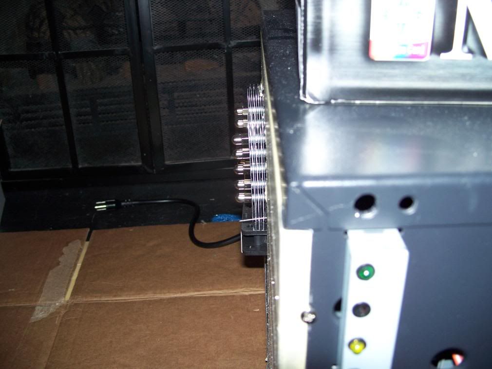

    here is a shot to show you how much the scythe cooler sticks out after I get the door on.

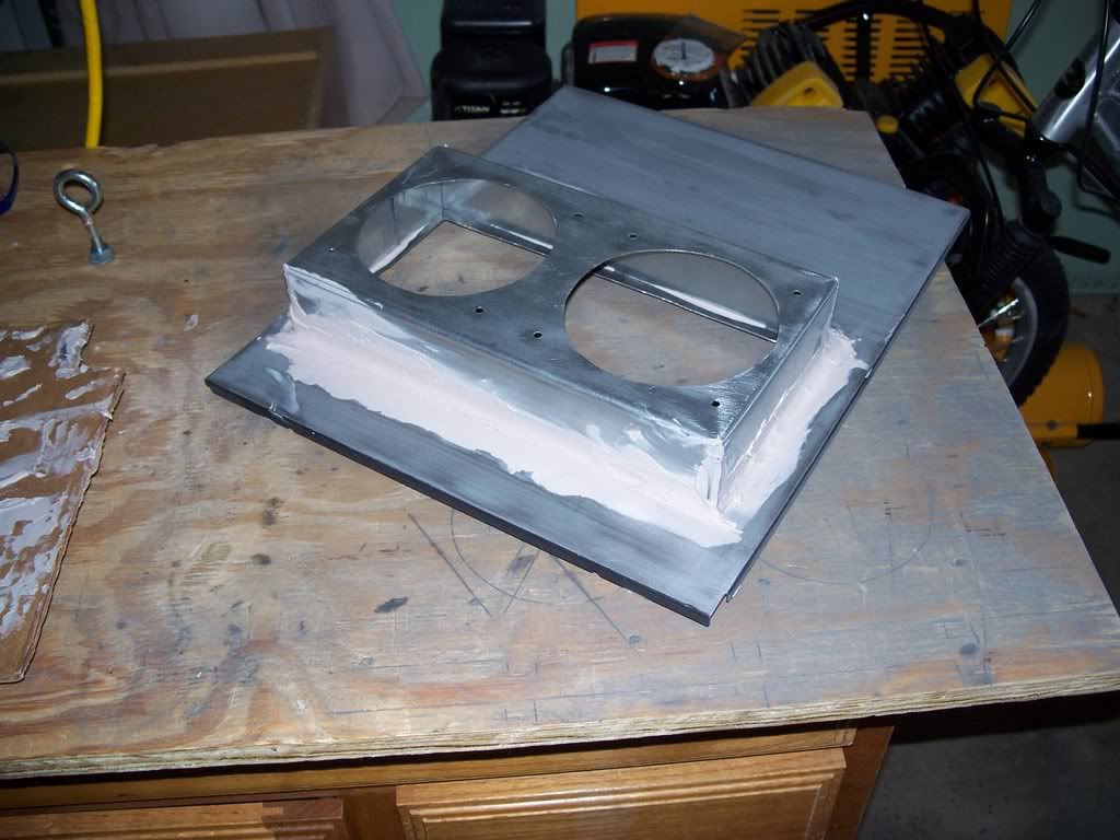

    got the bumb out mounted and need to get some bondo for it.
    and a shot of the tabs in place holding the bump out in place.

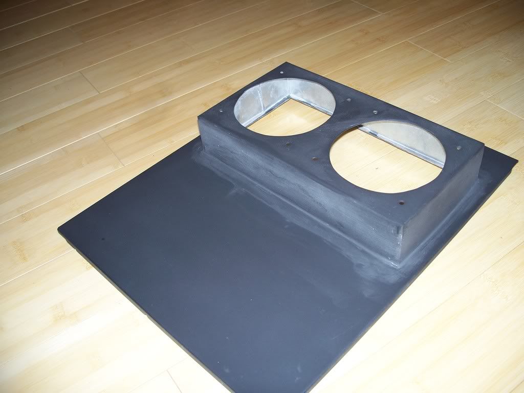

    Thanks for the rep guys and the patience I must have caught the flu bug cause I haven't been any good to anybody since the last post.

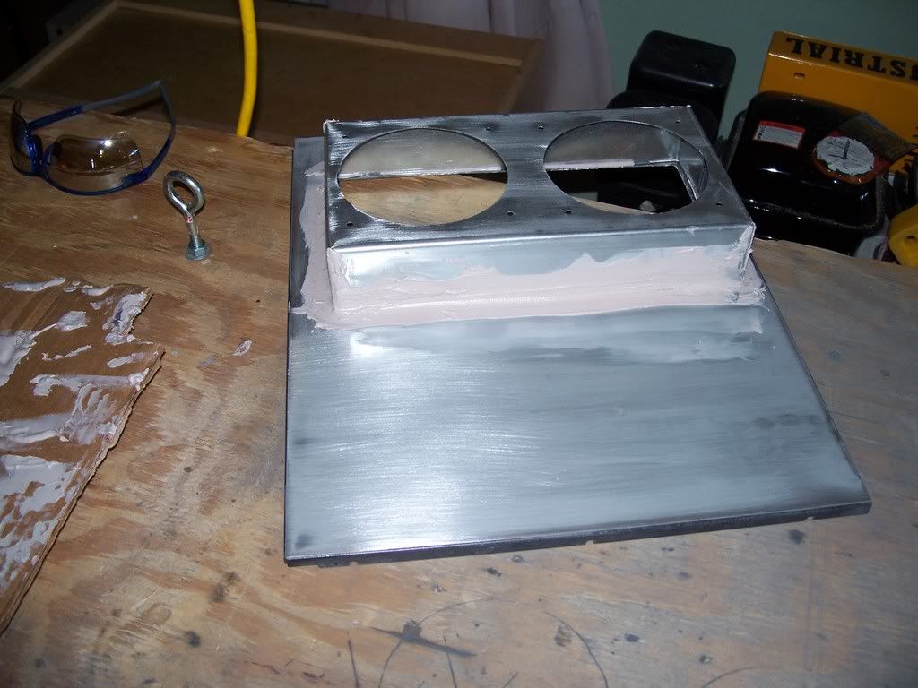

    I did sand the side down and get some bondo on it but the rest will wait till tomorrow at least when I can sand it and start the paint job hopefully. Once I get the side done I can fire it up and see if my drives survived or if I need new ones. then I will start the sleeving job. Thanks again for the rep and your patience.

    Ok quick update tonight I finally got some bondo on this piece and did some sanding followed by more bondo and more sanding finally a bit of primer to show me where I need to do some more work.
    Well I'm sorry I dont have more but this is my first time working with bondo and its a little trickier than it seemed from the directions on the can. As you can see from the last shot I still have some work to do with getting the bondo smoothed out so I can paint it without it showing through.
