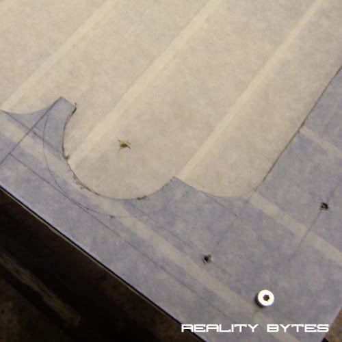

I had already marked out the cutting lines for the black piece:
I started by using a holesaw to get a perfectly round curve:
Then with the jigsaw cutout the rest:
Leaving a frame to cover the clear piece of plexi:

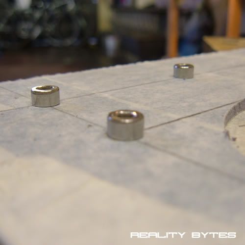

Next I cut 4mm holes for the bots to hold both bits together:
And used M4 socket bolts to secure:

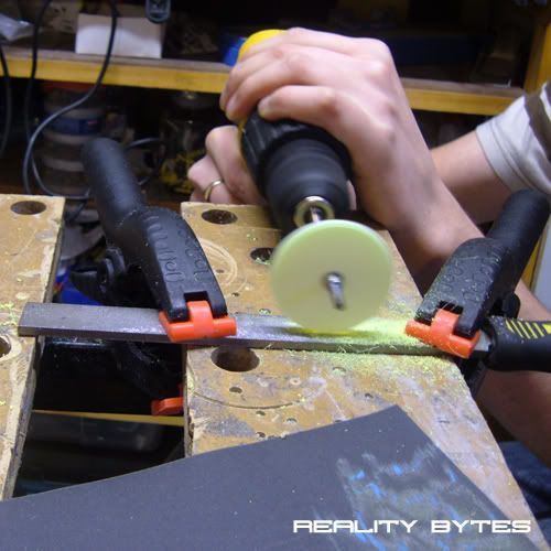

Next to add a little detail to the panel I cut a circular piece of UV green plexi using a holesaw and fitted it to the end of the drill, allowing me to file and sand to a perfect finish:

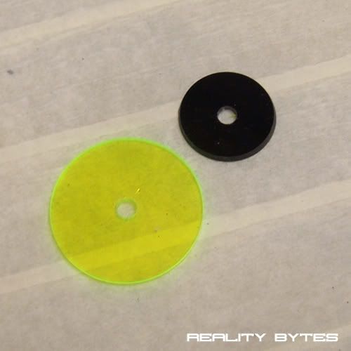

Then the same, but smaller with a black circle, giving me two pieces:

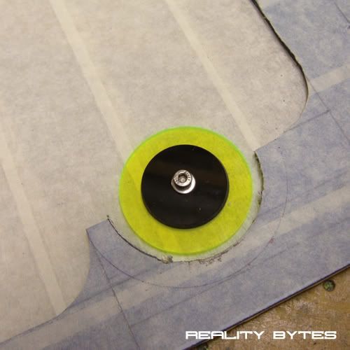

Then cut the a mounting hole in the panel:
Before bolting together:
The idea being the UV green circle will glow from the light inside and appear to be 'floating' against the clear plexi.
I couldn't resist having a peek, so took the masking off the black plexi. I have left it on the clear piece for now as I still need to cut a hole for the res to poke through:
I'm really happy with how it is looking so far and think the curves and green circle really fit in with the theme of the case.
