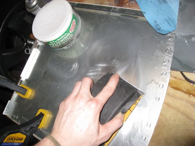

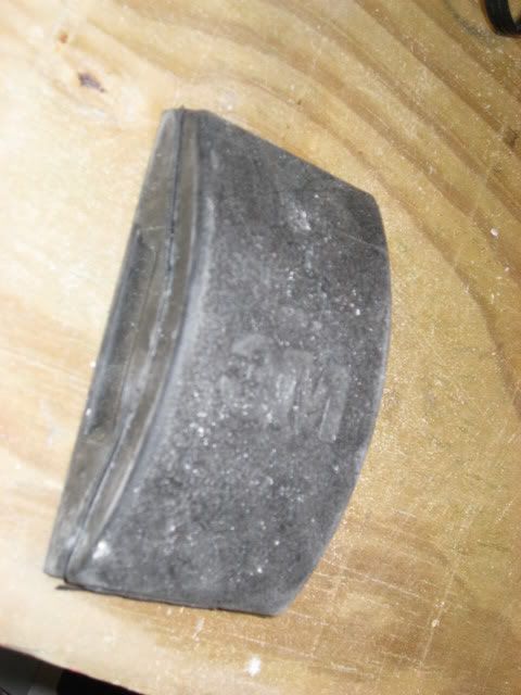

a sanding block:

First i sanded the area i was going to polish with some heavier grit sand paper(about 200) to get it down to bare metal:
then slowly worked the surface with my sanding block and sand paper:

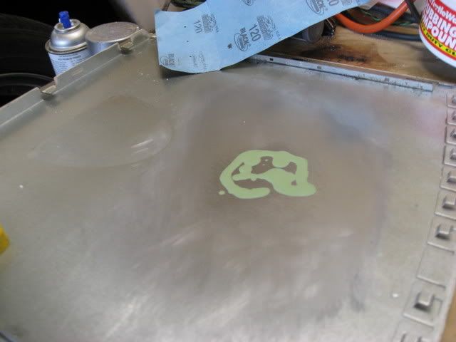

Using my paper towel and rubbing compound i ran over the surface again, bringing it to this finish:

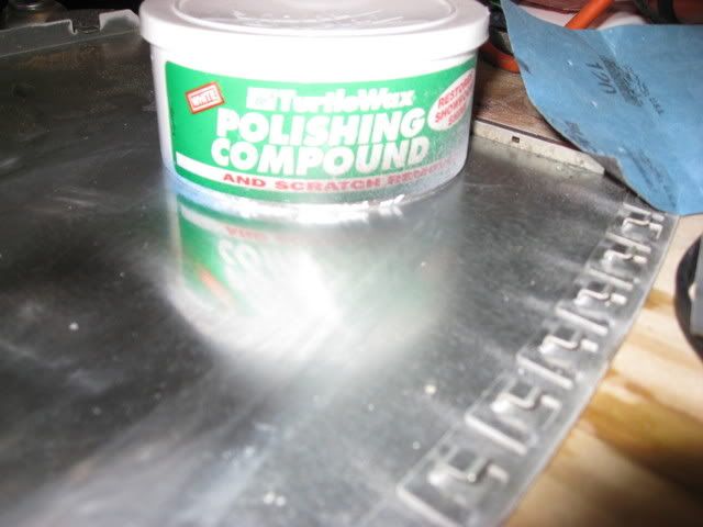

Now i added some of my polish compound:

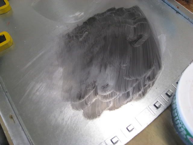

And using your polishing cloth begin to rub away
When polishing you will see your compound go from its original color to a dark grey, this is the metal getting worn, which is what you want:
then using a clean area of your polishing cloth, wipe away the polish and rub it a bit more to get it all clean and you will be left with a mirror finish![]()
