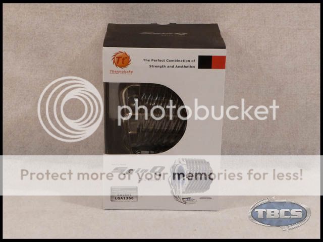

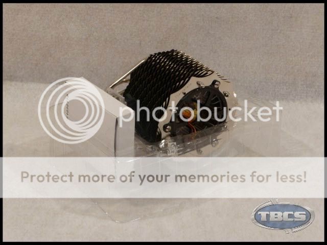

The box has been clearly designed for display, with a huge section of cardboard missing to display the actual cooler, rather than a picture:

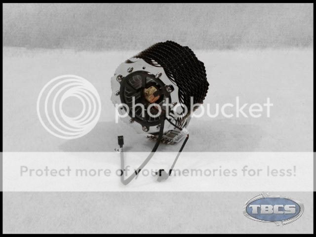

Inside the cooler is cradled in a molded plastic shell that has in this case done a fine job of protecting its numerous fins.

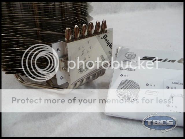

Inside the box with the cooler are all the hardware pieces you will need to mount the Spin Q onto just about any CPU you may be using, as well as a small tube of Thermaltake’s thermal compound, plenty for several mountings of this cooler. The Spin Q officially supports Intel socket LGA1366 and LGA775 as well as AMD socket AM2+, AM2, 939 and 754.
Once we get the Spin Q on the bench we can get a good look at it and its various components.

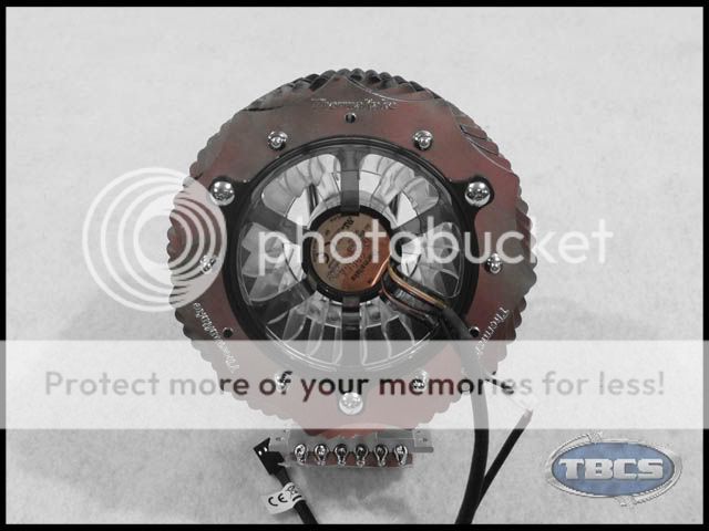

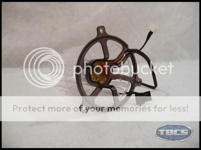

There are two leads visible here, one is a standard 3-pin power connection (sorry, no PWM here), and the other is a manual fan speed control. Without any sort of automatic speed control this is a must.
The Spin Q is unlike most other coolers in that it uses a centrally-mounted “squirrel-cage” fan, inside the heat sink assembly. This fan draws air into the center of the cooler and expels it through its entire surface, maximizing contact with the cooling fins. To some this may be an issue, as it does not in any way direct the hot air it removes, but simply expels it equally around the entire cooler. This should be noted by those who have specific air flow needs for the rest of their case.
You can see here the fan mounts with three screws directly into the cooling fins. There are three equally-spaced additional holes so that the fan can be positioned however is best for cable routing in your setup. A nice touch and one that many with more crowded (or neat) cases will appreciate.

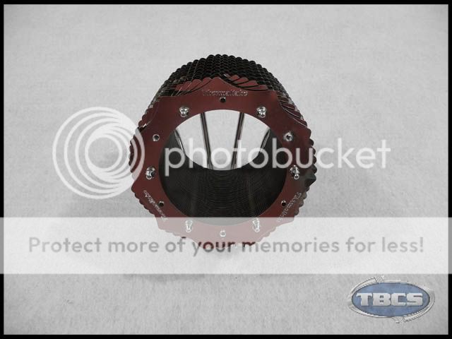

Take the fan out and the surface area of the cooling fins on the Spin Q becomes more evident;

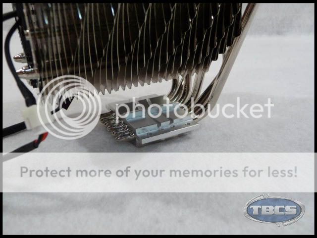

The bottom of the Spin Q has two grooves cut into the top plate to accommodate the AM2 clip, and four countersunk screw holes for mounting the LGA pushpin brackets. The mating surface is one of the most highly-polished I’ve seen from the factory.

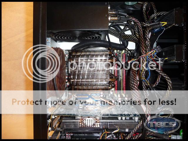

Mounting the Spin Q onto an AM2+ setup is simple, far more so than any other large cooler I’ve tried, as the round shape allows access to the retention clip. Not a single component had to be removed from my system to install it. I’ve not tried mounting it with the Intel push-pin setup, but I have read a few reviews that said it was difficult to reach the pins to install. You decide.
